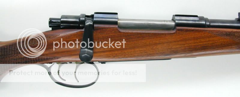

Hub Sports, Abbotsford, has a 7 x 57 Brno in on Consignment.
Has a 4 power Redfield with a post and horizontal crosshair.
Set Triggers, with a price of $750.00
I case someone is interested; It just may be someone's ticket.
Nechako said:
I just have to keep telling myself that I already have a BRNO in 7x57 and as much as I would like another, I don't really need another :( :bangHead:
Nechako
Oh yes you do! A 21H with double set triggers is a perfect twin man!:rockOn:
The only way they get better is when they are the older version with the claw mounts.:cool:
Good price if it is in nice shape! Wish mine had the double triggers.
It won't last long.
Wood stock, some checkering . . . did not look that closely as I was scared to be tempted. Phone in the AM at 604 859 8316. Probably used by a hunter. Has a barrel band for a sling. It felt pretty handy.

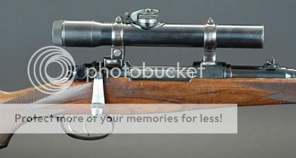

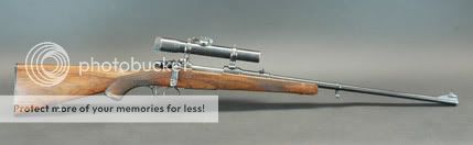

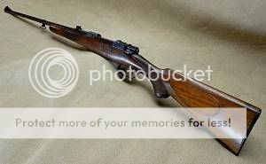

Has anyone ever seen an older version of the 21 or 22 models with the German claw mount as compared to the double square bridge? I will post some pics of a wicked little 9,3x62 I found.
Whoops, the 9,3 doesn't have claw mounts, but this here other one does!

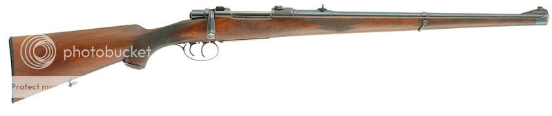

Or how about this little sweetheart!
Great pics Noel, those sure are nice rifles.

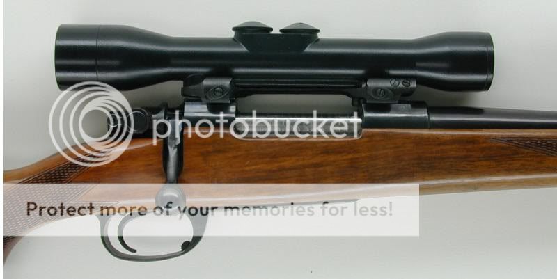

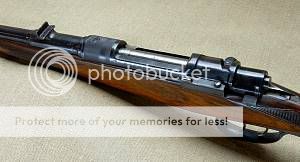

Here is the 9,3 I spoke of. If I had an opportunity to get one like this I'd be swapping out my ZG in a heartbeat.:) It is nice, but I just have a soft spot for the 21's.;) Boy it would kick!
Note how the above 21H (the scoped one) has the ZG47 style safety, they seem more often this way in the Europoean countries. They take some getting used to that is for sure. Forward for safe, and back to fire.

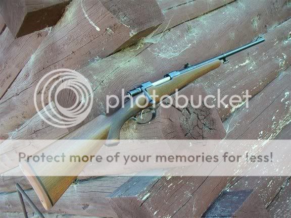

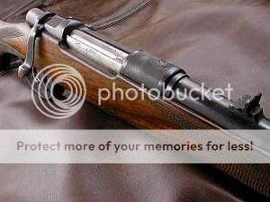

I think I found these on the 24hr campfire. IIRC it was in N.Y.
I think the same guy has this one too.

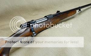

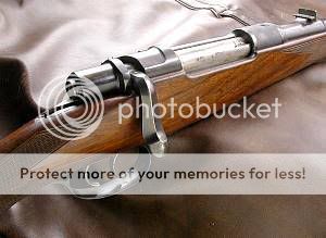

This one is from the 24hr Campfire too, It is a rebarreled 21H, chambered in either 9x57 or 9,3x57. A very nice carbine to pack in the hills.
