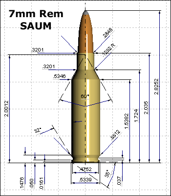

try 66grs RL25 behind a 160gr Accubond in the real 7-08 Improved ;)
