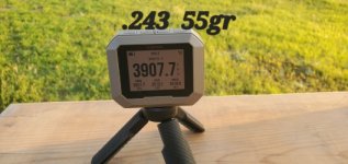

My coyote medicine is also the 55g ballistic tip. Started with H335 powder but found it too temperature sensitive and switched to H4895.GetAttachmentThumbnail.jpg
