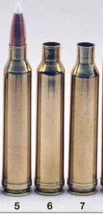

I'm convinced I'm building a 7mm Practical on a Winchester 70 classic action in M24-40 contour. I don't hear a lot of talk about that chambering in Canada, but if you know a gunsmith with a reamer for that, let me know please.
Thank you.
Unless you are going to lengthen or replace the magazine box and open the loading port while adjusting the bolt stop and ejector and adding holes to the rear bridge I’d steer clear of that cartridge.
Bullet profile is different. You will be seating bullets really deep. You will also be restricted on what bullets you can actually use.
Thanks. I was under the impression that OAL was the same for 7-300 win mag and 7 practical, the difference being a 30 degree shoulder of the Practical. Either way, I'm still on the lookout for a good smith to do this work.
https://www.ballisticstudies.com/Knowledgebase/7mm+Practical.html
"The Manson reamer will cut the chamber to produce a max COAL of approximately 91mm (3.583) using the 162 grain ELD-M or 92mm (3.622") using the 180 grain ELD-M. This COAL suits a very wide range of bullets without compromising magazine space. Suitable actions include the Win M70, the M700 and its clones"
My rifle is en route, so I guess I'll have to look at my magwell and see how long it is, but I suspect it's close to 3.4", so if that's the situation then you're correct and some additional work is in order to house that round.
Using a 300wm donor you’ll probably need to machine the rear bridge if you want to be able to eject live rounds. Other mods are needed
Using a 3.6 mag chambered (express) action would have been a better start. 300wby, 7mm stw, 375 hh, 416 rem mag
Buying a reamer is the cheapest part of your plan.
Any decent smith could do the work
