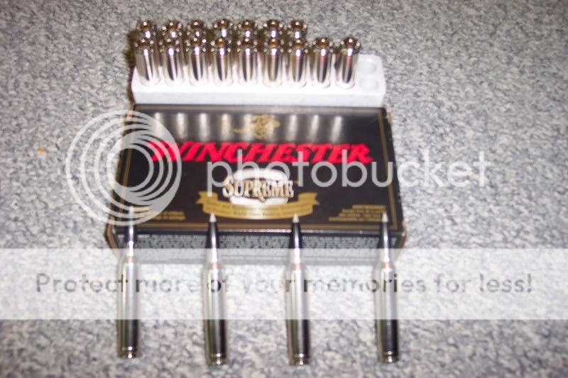

I just bought these the other day. Pretty damb expensive at $35 a box. I'm going out sunday to do some sighting in, so we will see how they preform. They just look so sweet, i dont even want to shoot them.
