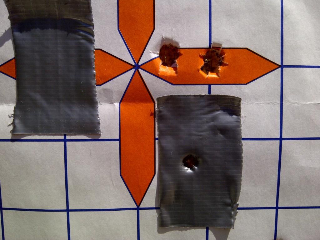

Ive been useing RL 19 in the 65gr range in my Ruger.Im useing 140gr Nosler Ballistic tips.My group is great.A 5 round string made two holes ,I pulled one about 1/4" to the top left
