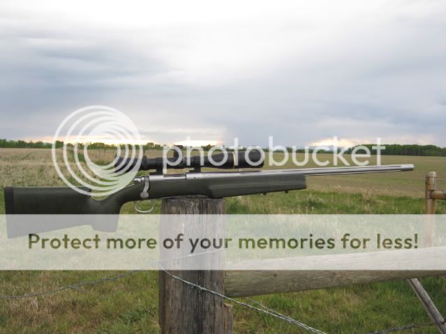

in my 26" barrel I'm getting 2980 fps with a 160gr Accubond (66grs RL25) and now am playing with the 180gr Berger Hybrid for long range target shooting at just under 2800 fps with H4831sc.
