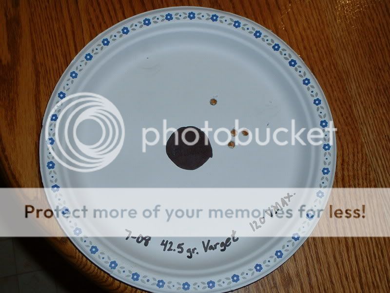

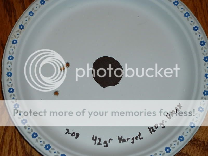

So, I did some experimenting. I used 42grains of Varget and 42.5grains of varget as well.
It seems that the 42 grains group tighter.
No matter what I do, I always have a flyer out of my Stevens. Its usually the first one down the tube, then the rest make the tighter groups. Oh well, I can live with it.
So, I think this is going to be a sweet gopher round. Im not sure how many FPS they are cruising at when leaving the barrel, but my guess is around
2800-2900 FPS.
Blackdog is loading up some in the 7mag tonight. Should be interesting to see how they group.:rockOn:
I will post my pics tonight about this afternoons session.:)

The reason for the left/right groups is that I was adjusting the scope. The groups look decent enough though.
