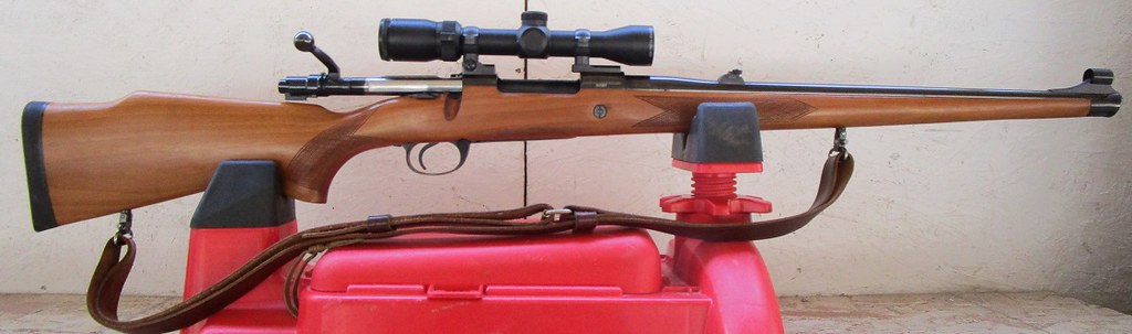

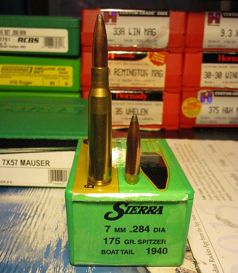

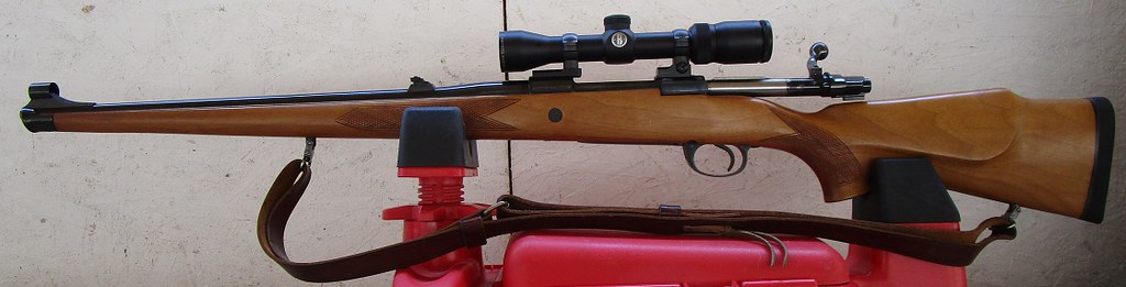

Developed a load for my 7x57 with the 175gr SBT GameKing using a near maximum charge of Re22. Top muzzle speed is achievable with this powder and bullet weight according to the Woodleigh loading manual and Speer No.12. Chronographed at about 2575 fps and groups about 1" off the bench at 100 meters. This rifle has a 20" 1:8.66" twist barrel.
Also off hand accuracy as shown which is the real test once the rifle is sighted in.
7x57 Zastava LKM70 Carbine with Bushnell Legend Ultra HD 1.75-5x32mm
SAAMI specified maximum pressure is 46,000 cup in deference to the weaker Model 93 and 95 Mausers. The load I'm using in my modern 7x57 rifle safely exceeds that pressure level according to Speer No.12.
For comparison, muzzle speed for Federal Power Shok 7x57 175gr ammo is listed as 2390 fps, likely in a 22" or 24" barrel. 200 fps faster with a 20" barrel is a significant improvement.

The 7x57 seems to use powder rather efficiently. Barnes No.3 also lists Re22 for top muzzle speed with their 175gr bullet and 2nd highest muzzle speed using IMR 7828. Classic round.
