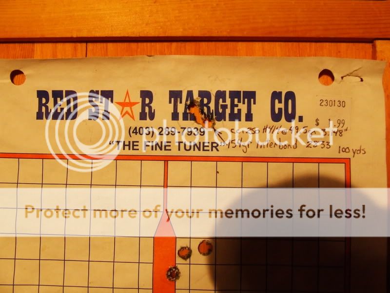

140gr psp CCI250, RL19@54gr 2797
H414@ 49gr 2820, 51gr 2930
H4895@ 43gr 2775 3/4" groups as in the pic (untitled group)
145gr GS CCI250, H414@ 51gr 2950
