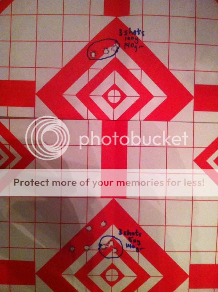

Original sight in. I can't recall if this was S&B or Remington ammunition. I also can't recall the bullet weight if it was S&B then 173 gr if it was Remington then 140 gr. (2x power)
140 gr Remington Core-Lokt at 2x power

(Note: if these photos look familiar its because I have posted about this before in other threads)
