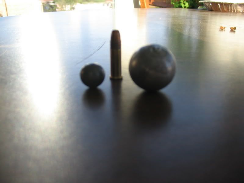

Here ia picture of the ball compared to a 22 LR and a 45 cal ball. The ball is 825 in diameter and weighs 800 grains

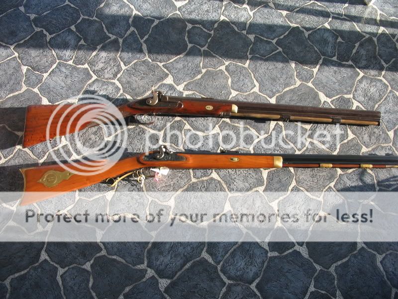

Here is the 8 beside a Thompsen Center Hawken. There is only 1/2 pound difference in weight. The 8 bore weighs 9 pounds and the TC is 8 1/2 and the 8 is shorted by a couple of inches

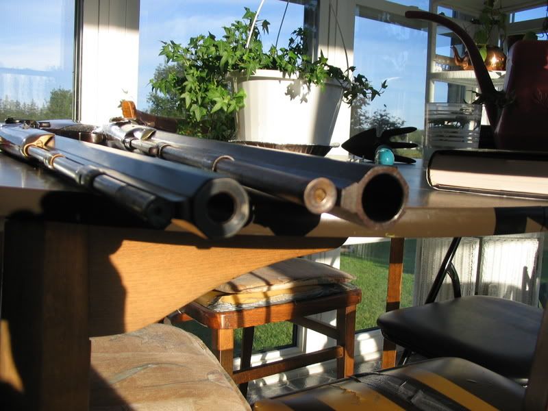

Here is a picture of the muzzles, 45 cal TC and the 8 bore.
