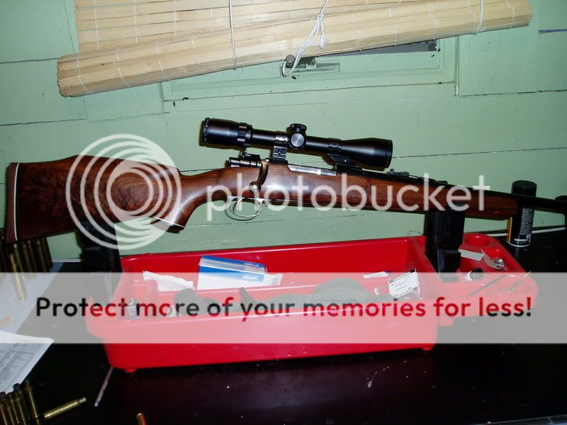

I've decided this winter project will be to turn my 8x57 98 Mauser into an 8mm / 06 .
-Is there a gunsmith in Vancouver anyone would recommend ?
Definitely no good reason other than I want one. Having said that the Mauser I have shoots 200 gr very well, double set triggers seem to help that. Trajectory of 200 gr from the shorter case is a bit of a rainbow . 10 gr. extra will flatten it out a bit. what I'm looking for is a lower mainland guy with the reamers and exp. to do the job.
