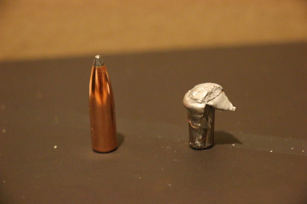

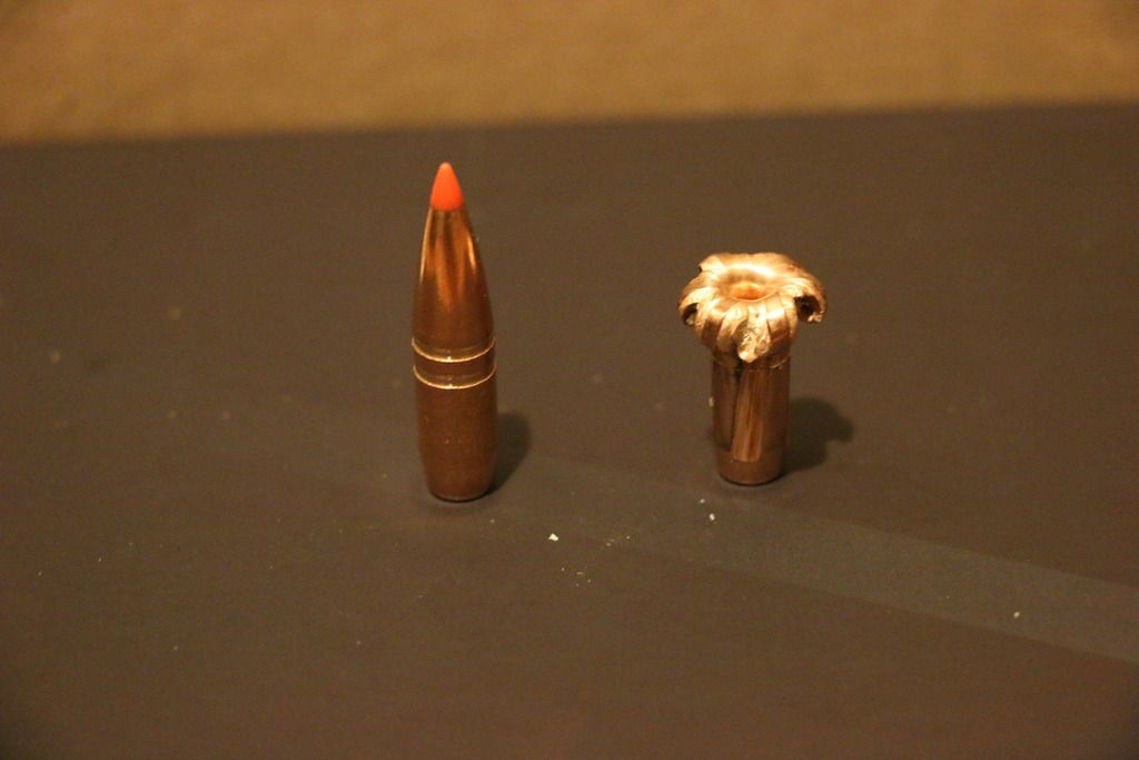

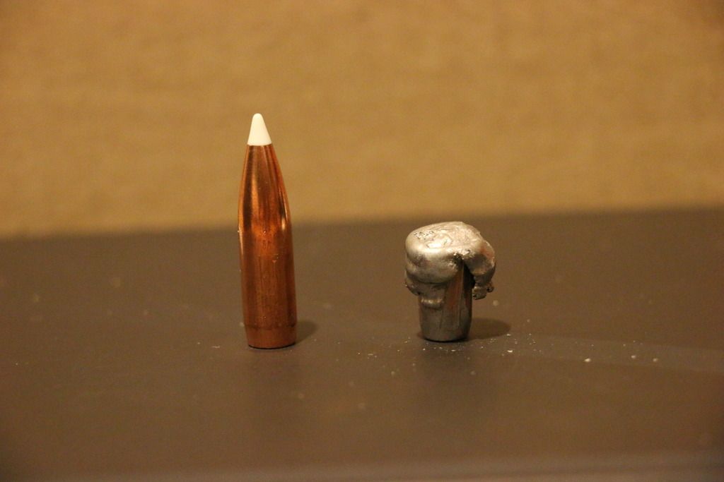

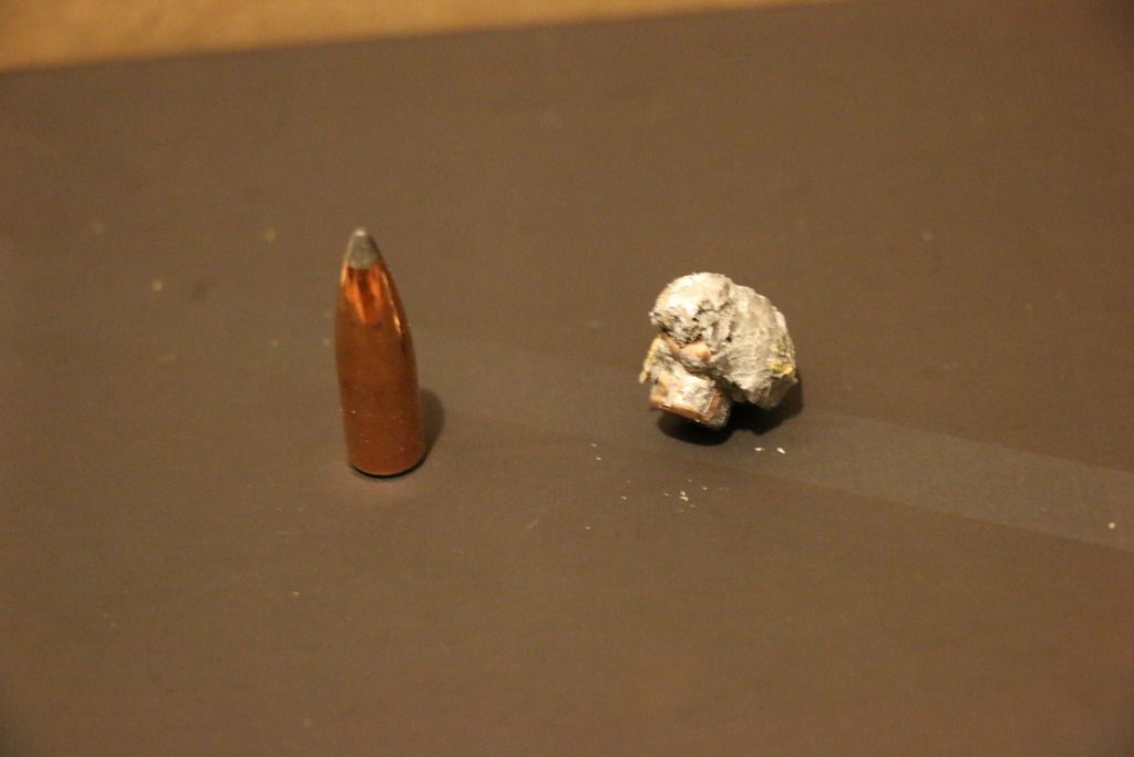

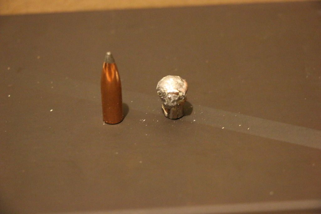

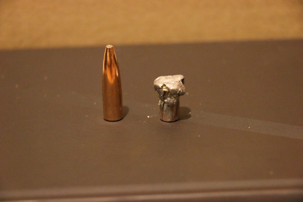

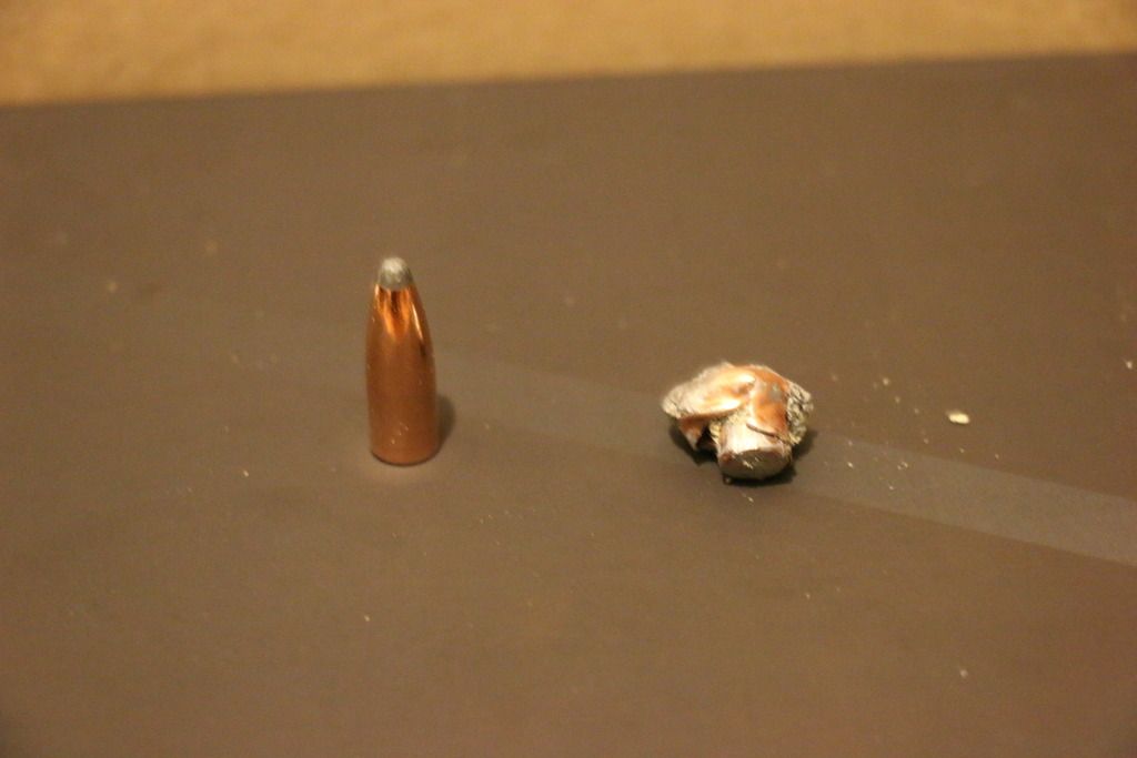

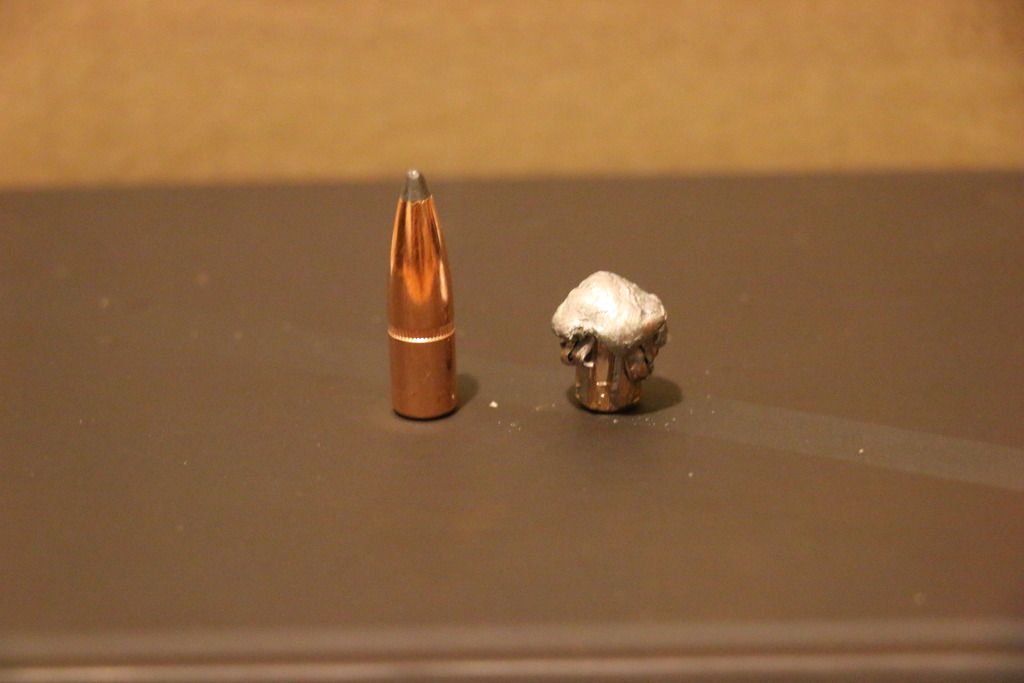

Decided to test some 8mm bullets in a stack of 2x8" pine wood stack about 2ft in length. Its my first time doing this so bear with my pictures and and info.
Most Bullets preformed well.
Caliber: 8mm mauser
velocities:
170-180: 2650ish upon impact
195-200gr 2450ish upon impact
220gr 2450ish upon impact

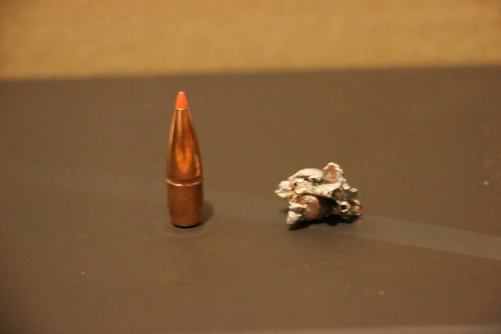

Bullet: 170GR Hornady SST
Retained: 117.4gr
Retention: 69%
Comments: Very Rapid expansion, good deer bullet. Penetration was about half way so about 1 foot.
Bullet: 170gr Speer Hot-Cor Semi spizter
Retained: 135gr.3
Retention: 80%
Comments: Penetrated a few inches better then the SST
Bullet: 175GR Serria Pro-hunter SP
Retained: 149.9Gr
Retention: 86%
Comments: Penetrated like the Speer 170gr
Bullet: 180Gr Hornady GMX
Retained: 178.1 GR
Retention: 98.9%
Comments: Great performance, penetration was about 3/4 thru the stack of wood. Not sure how reliable the expansion will be at 300Yards
Bullet: 195Gr Hornady Interlock SP
Retained: 160.6
Retention: 82%
Comments: Penetration was like the GMX

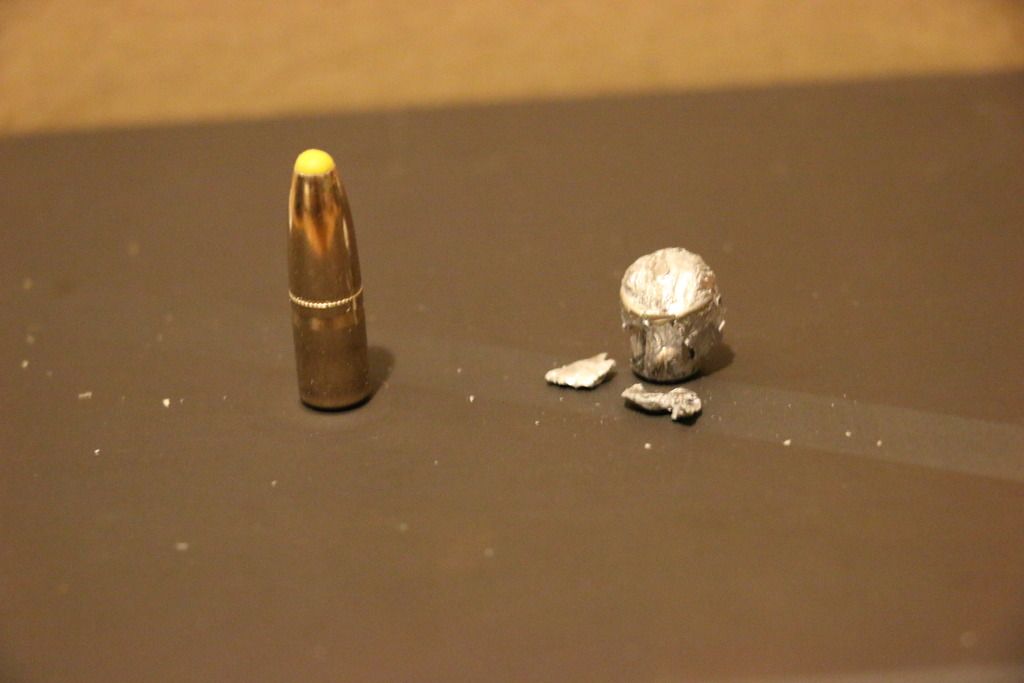

Bullet: 196GR Norma plastic Point
Retained: 123gr
Retention: 62%
Comments: core held intact and penetrated just as well as the GMX
Bullet: 200gr Woodleigh PP
Retained: 175.6gr
Retention: 88%
Comments: Penetration was excellent....exceeded the GMX by a few inches.

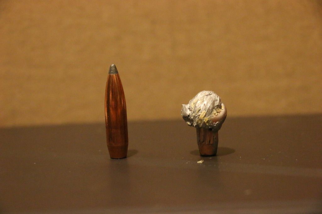

Bullet: 200Gr Nosler Accubond
Retained: 158gr
Retention: 79%
Comments: Penetration was like the GMX. Great looking mushroom
Bullet: 200Gr Nosler Partition
Retained: 175.8
Retention: 88%
Comments: Penetration was like the GMX. Good bullet.
Bullet: 200gr Speer Hot-cor sp
Retained: 177.5
Retention: 89%
Comments: Surprisingly retained the most weight from the 200gr class bullets and its only a cup and core bullet!! Penetration was like the GMX
Bullet: 220gr Serria GMK
Retained: 186.9
Retention: 85%
Comments: Great looking mushroom, penetration was similar to the GMX.
Im pretty impressed with the these bullets......the sst was pushed to hard. I think in the sst load it was a regular charge for an honest 2700fts upon impact, so im sure it will do better when reaches the 50-100 yard mark.
