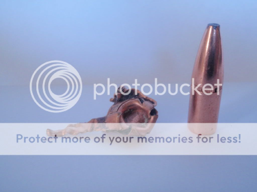

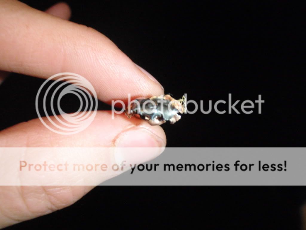

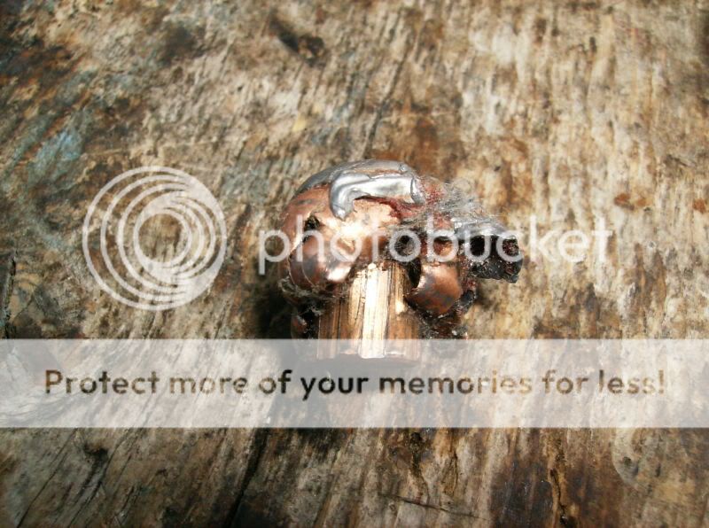

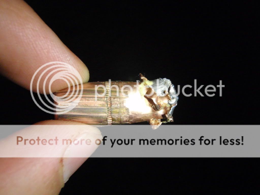

They didn't work fine on a cow I plugged at 180 yards with a 286gr Hornady from a 9.3x62 She was hit on the back edge of the shoulder blade and the bullet went to pieces leaving nothing but a large surface wound.Required several followup shots.Interlocks have been failing for me in several calibers as of late and I never had a problem with them in the past 30 years.I think they have changed their jacket contruction but they won't admit it publicly.I have a 180 gr driven at 3000fps out of a .308 NM that didn't even expand going through a mulie doe length ways frontal chest shot................Harold
I can second that statement, the Hornady's got softer....read lousyier. Before GMX and Interbond showed on the marked the IL were very good and dependable bullets, not so right now.... IMHO the corporate bean counters want more profits so we should buy the premium bullets and get dissapointed with the use of the "old" ones.

Top is two Hornady Interlocs one blown apart on a cow moose from a 9.3x62 at 2400fps ,The other unfired Unacceptable failure YES IMO .... second + third pic from a .308 NM at 3000fps 180gr Hornady frontal chest hit on Mulie doe never expanded through 1 yard of flesh Unacceptable Failure YES AGAIN IMO...........Harold
Harold the first pic of the 9.3 bullet is pretty sobering , there isnt much of that bullet left.
I take it that this is the bullet that came apart on the shoulder blade of your moose ?
