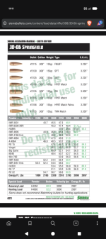

With all bullet weights? 200 to 300 gr? That's a bold statement. Do you mean like 4350 is the best in 30-06, where it's too slow for 150gr, but good in 180s?
Since when is H4350 too slow for 150 grain bullets in the aught six? News to me. Because it gives close to top velocity among other powders, and has been a staple for that cartridge and bullet weight since it's inception.
Since a long time.
