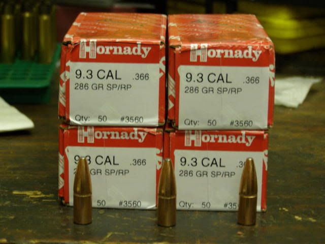

Recently Hornady started marketing 286 gr 9.3mm spitzer bullets. These are the same bullets that Hornady has been using in their 9.3X74R ammunition.
I was able to acquire four boxes(50/box) and yesterday I had the opportunity to get to the range to try them out. The crimping grooves on these bullets are useless for crimping purposes in the 9.3X62. They are apparently placed for crimping in the 9.3X74R

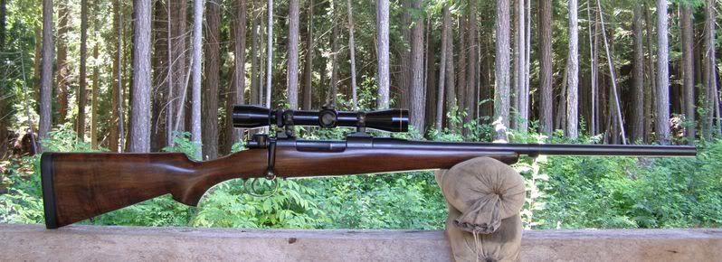

The rifle is a Brazilian Model 1908(Oberndorf contract) Mauser 98 with a 21" barrel, Dayton trigger and a 2-7X33 Leupold VX-I scope.

That rifle has very nice lines. Based on your sig line I won't ask how it feeds. I don't think any critters will get away from those 286 gr Hornady's, and it appears that your velocity is just right to make "magic" happen.
