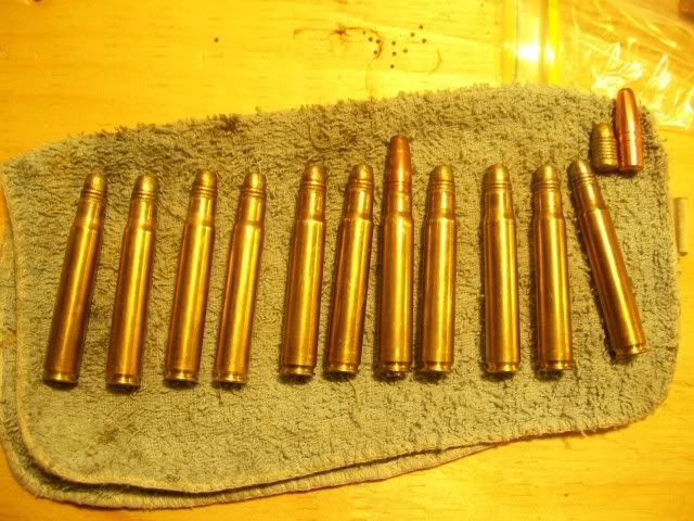

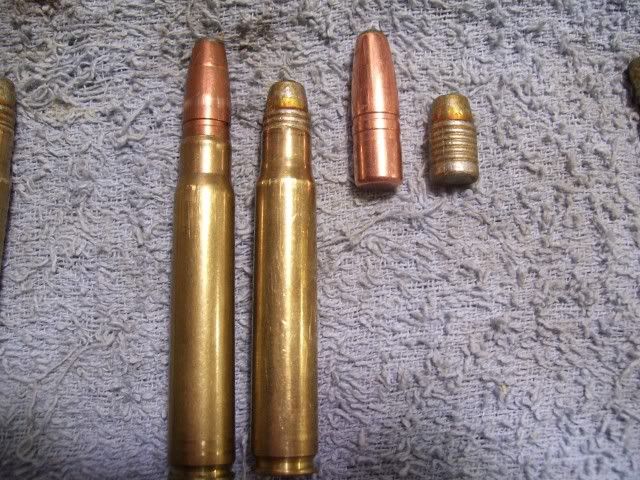

I was bored so I took this advice.:D I'm not sure how well they'll shoot, but nothing ventured nothing gained. At least I tried....will give them a test run after I break a trail to the the woodpile. I put a dummy cartridge in the mix for a size comparison. 13.1 grains Unique for the powder charge.

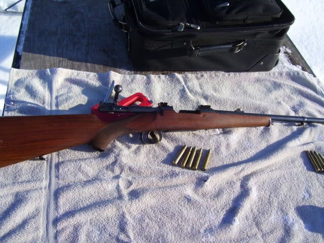

Here's my model 46a Husky back in her original stock for the day. I also had to poach the front action screw off my m-96 Swedish mauser seeing the one for the Husky snapped.

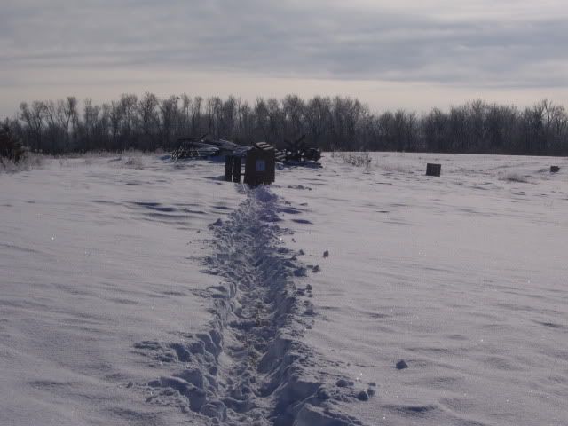

Here's my little slice of heaven at 50, 75 (woodpile), 100, 200+ and the 300 meter is out of view . I zoomed the camera so it doesn't look quite right.

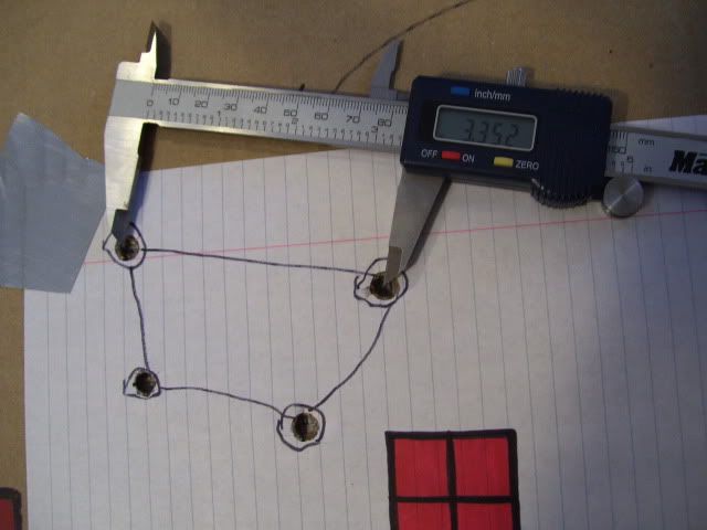

First group of five shots........where's the fifth?? Only about 20" away down to the bottom. We'll call that a flier.:D
A closer look at the group.

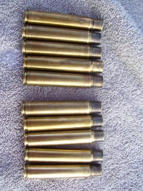

A pic of the fired casings showing almost completely sooted necks.

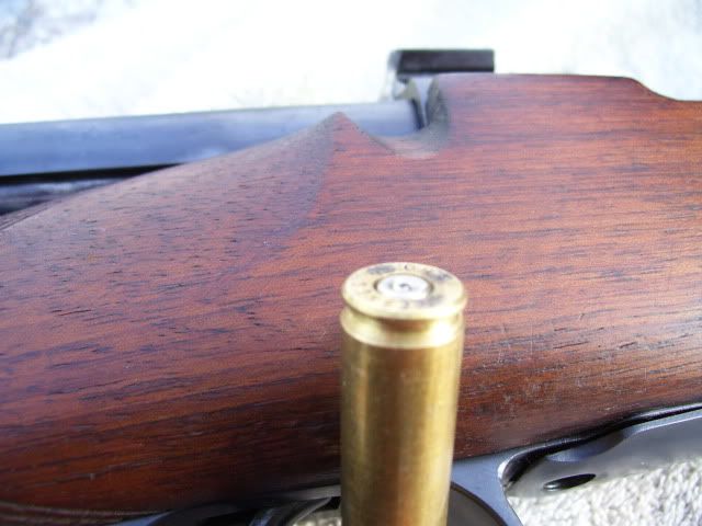

A pic of the primer backing out slightly.....

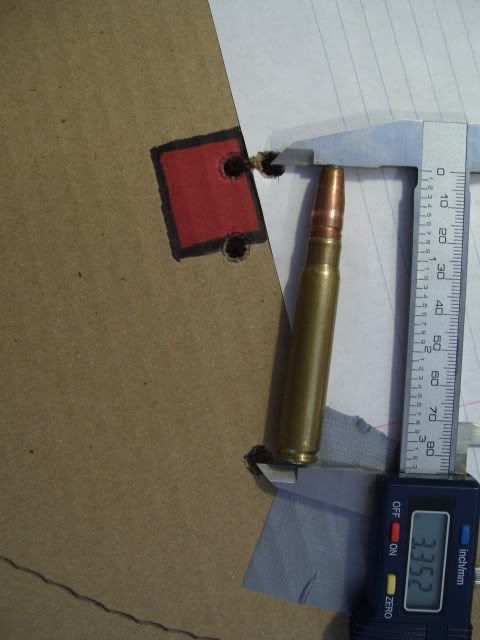

The second five shot group. Wheres the fifth?? About 14" inches away. We'll call that one a flier too.:D

All in all it was fun to try out, and I'm going to try teflon tape next. A few of the bullets seated easier than the others, I'm almost thinking they were the fliers. Recoil was very pleasant, higher than a 223 but less than a 30/30 factory load.

Interesting thing about both groups was the fact they measured pretty much the same if the flier is taken out of the equation. There was a bit of leading, but nothing to be concerned about suprisingly.

Truth is even though it didn't get awe inspiring groups it was fun to give it a try. I did notice the teflon wrapped bullets did bump the pressure (I'm assuming) for the lack of soot on the neck and the primer not backing out somewhat.
