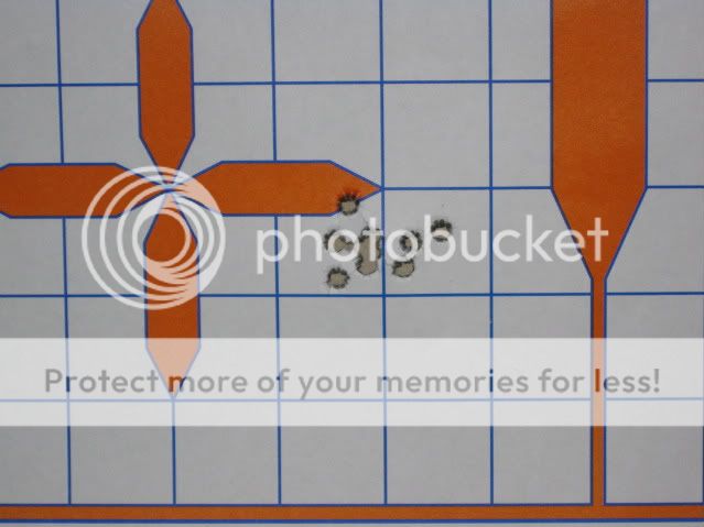

Here is some info that SteveB emailed me.
"Hi Jerry, Mick and Ian
I loaded up some of the Berger 90 VLD’s Jerry sent up this week and went out this morning. Slight breeze but mostly calm’ish conditions with no mirage.
I shot 10 shots at 300 meters from the mat using the Rempel bipod as if I was shooting a match.
I think this qualifies as a good target, however, I feel considering the way I shot the group, I could actually do better. Time will tell.
Jerry, you can post it on CGN on the tread you started if you want to talk about the 22BR. Velocity is about 2900 fps.
I believe this is the best target I have either shot at 300 meters.
My rifle was the new XR100 and the 6 x 24 S111 Sightron using the new 1 in 7 twist Kreiger barrel I got from Ian.
Steve

I opened the thread and walked away. Now there's a bunch of new stuff that showed up when I posted the above. That 300m groups looks very interesting.
You better get out to the range soon Jerry...this is looking very interesting.
