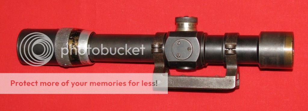

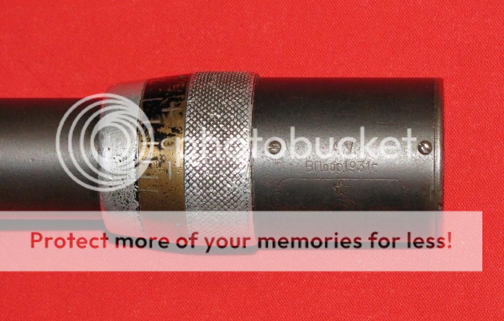

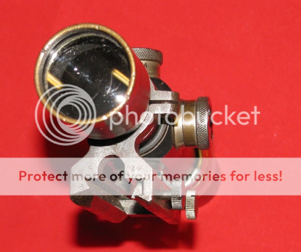

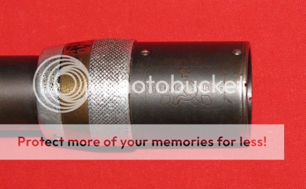

1. I picked up a PE/PEM scope/upper mount (hex). This scope has the focus adjustment. Mount is marked '431', scope is marked 'Ay 1931c' over '1936r' with 'NB 1141'. I am looking to mount it to make a sniper clone. Obviously I need a hex receiver, but which year is correct? 1931 or 1936?
Secondly what is the proper term for a scope with focus adjustment? PE or PEM? Sites swap back and forth?

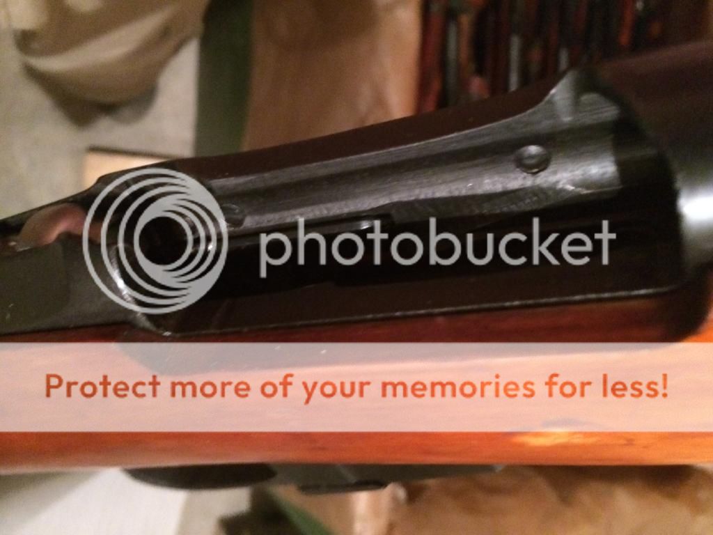

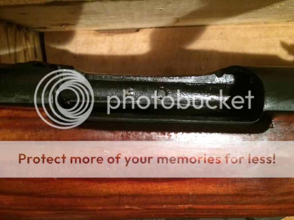

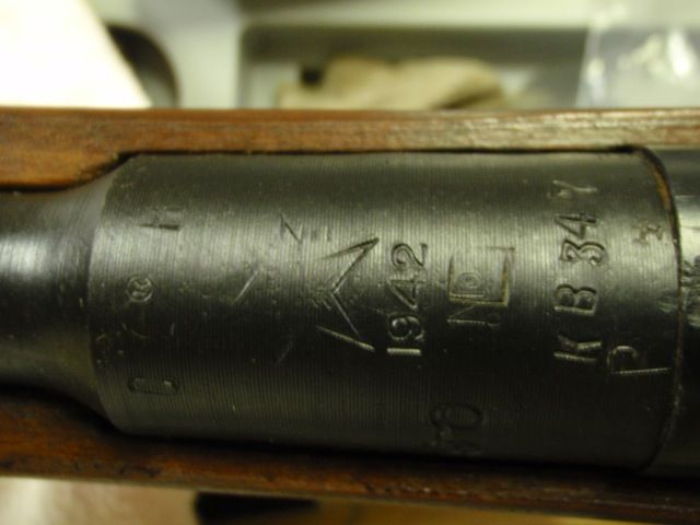

2. While looking over my rifles I have a 1942 izzy which I always assumed was an ex-PU sniper, but upon more research I discovered that it was actually one of the stop gap snipers with the non-focus PE/PEM side rail mounts. I'll post some pics later. Is it worth restoring? Or keeping as is?

I'd leave her as is....sounds like your scope was made in '31;. and moved to another rifle in '36...pics of the markings would help....could have been refurbed and reissued too,.. with the non orginal mount..
1. You have so called PE scope. Actually, there was no PEM and PEM scopes in russian terminology. Both were PE scopes, with focus ajustment and without. Original mount base is almost impossible to find. Your scope was produced in 1936
PE snipers with top (Smirnskiy is correct name) mount were produced in 1932-1937. Single examples are known from 1938.
2. Definitely keep 1942 Izhevsk PE ex-sniper. They were produced only 1 year. But original Izhevsk side mount is very hard to find

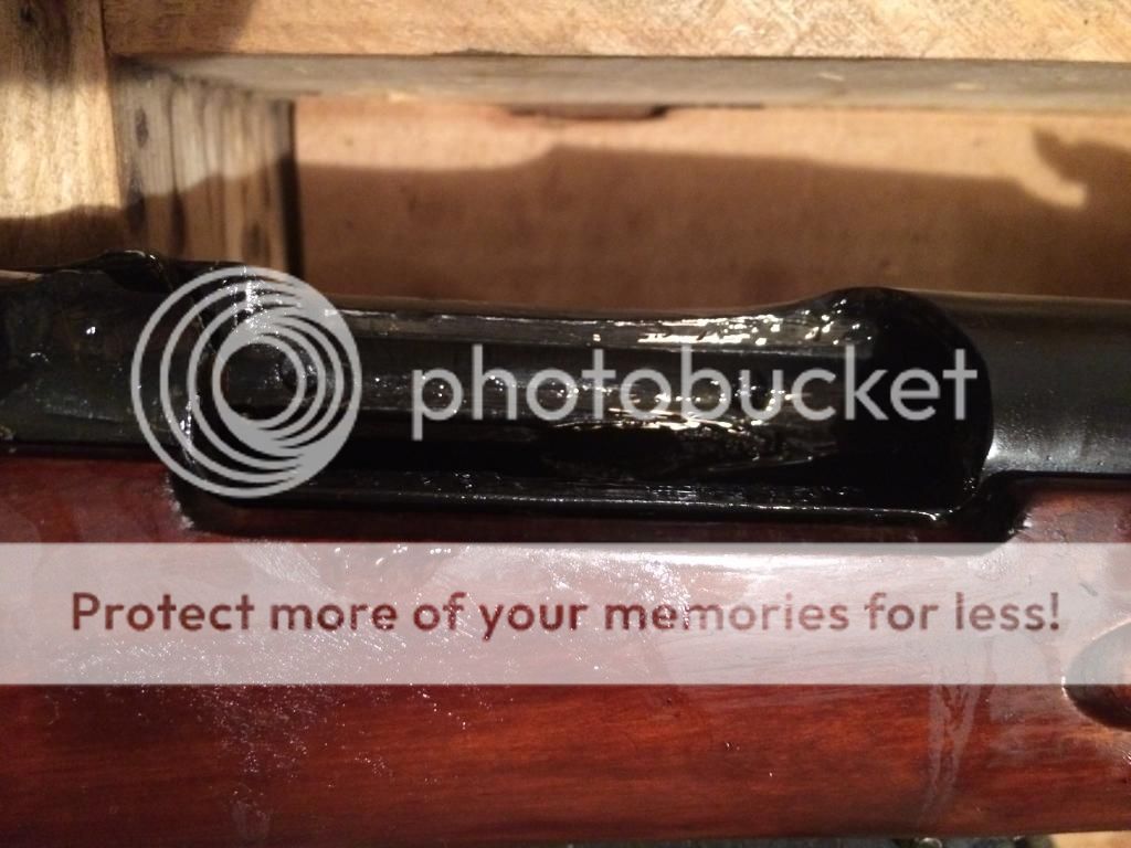

Here is mine restored 1942 Izhevsk PE sniper

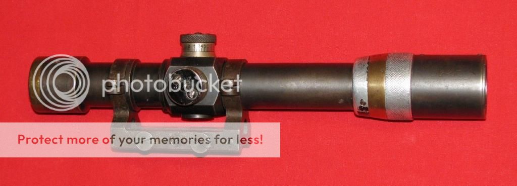

PE Scope Pics - Thank you again Ratnik

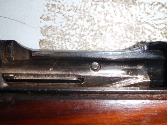

1942 Tula PEM side mt Only made for the first two months that year then all were the cheaper to make PU
They were produced in February-October. Last were produced after begunning of PU production. Source - factory reports. Anyway, very rare rifle, much more rare then Izhevsk 1942 PEM rifles
I know this an old thread but, would it be foolish to try and have it restored with correct side mount and bolt pattern or would I be destroying it.It has been refurbed already...the Accumount Chinese mounts have very soft screws and lousy scopes from what I've read.....Thanx Harold
