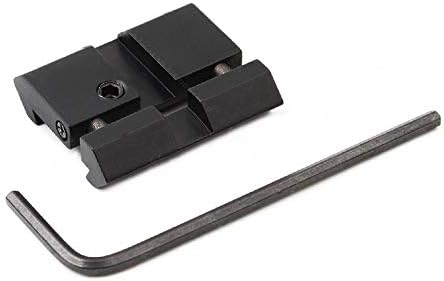

It's a 3/8" dovetail groove, any rim fire. air rifle rings should work, you could also use a weaver to 11mm adapter to run a small red dot directly.
They look like this and are cheap on amazon....

This guy is using a rimfire to weaver adapter that adds extra height over the style I posted earlier, looks like he still achieved enough accuracy for his hunt.

The 94/22 receiver is short. That and the 3/8 tip-off rail somewhat limits mounting options. There is a 3/8" to weaver standard base adapter that will mount to the grooves and allow scope rings to be further apart. Anything longer than a compact scope sort of overwhelms the rifle.

Also agreed, BKL makes some pretty nice canitlever mounts for airguns and rimfire dovetails. They work with 3/8" and 11mm.
