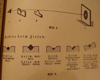

Extract from German K98k Manual
No, I don't speak German .... :D :D

Holy smokes! I guess I shoot with the far left S.P. i was thinking that was the ONLY correct way to shoot. but now that i see that it makes perfect sense to change it as required. anybody able read german hahah? it looks like the second from the left would be the most appropriate to lower my POI. thanks very much.

the only problem with that sight picture is that i'm going to have to squish my face into the stock to get the front sight that high!

Buck, you actually want the third from the left. The second from the left would only increase your problem. Your front sight is to low now and your K98 was sighted in for 300meters from the factory with issue ball ammunition.

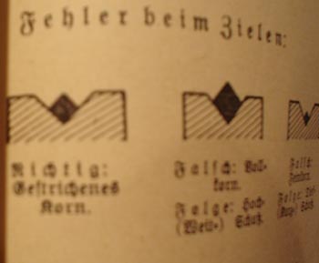

I do, if it's of interest I can translate that.
Top picture talks about mistakes while aiming.
All of these are declared wrong (falsch - this is old Gothic type) except the one on the left (richtig=correct). You couldn't possibly shoot with any modicum of accuracy trying to hold over by moving your front sight up and down in the sight.
