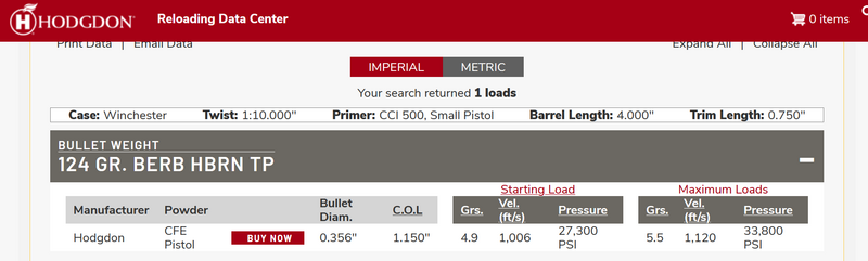

I can't imagine you would notice any difference in loading them, or shooting them. They are similar enough. I'm guessing the hollow base ones are a bit more expensive, but probably not enough, that it would be worth the hassle to return them and order the others.
Hollow base = Larger bearing surface, forward weighted, better expansion/seal. It's supposed to increase accuracy but you won't see a lick of difference between the CamPro offerings. They load just like regular 121gr RN bullets.
With the Berry 124RN and RNHB, I found the slightly longer bearing surface created a touch more friction, and at the same powder charge, the HB were a touch slower.
