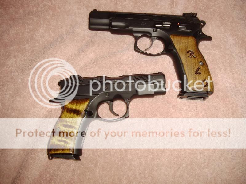

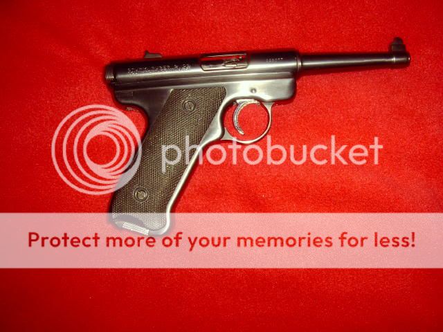

The only 22 pistols I have left:
and my CZ75 on top in the second photo
kadet
just changed the cz from 9 to the kadet kit, under 30 sec with time to spare:dancingbanana:using one gun, the draw and fire for the first shot is exactly the same as with 9mm, fantastic practice. as well, when goin fast it is easier to see, due to reduced recoil, if you are moving the gun before the shot breaks.
