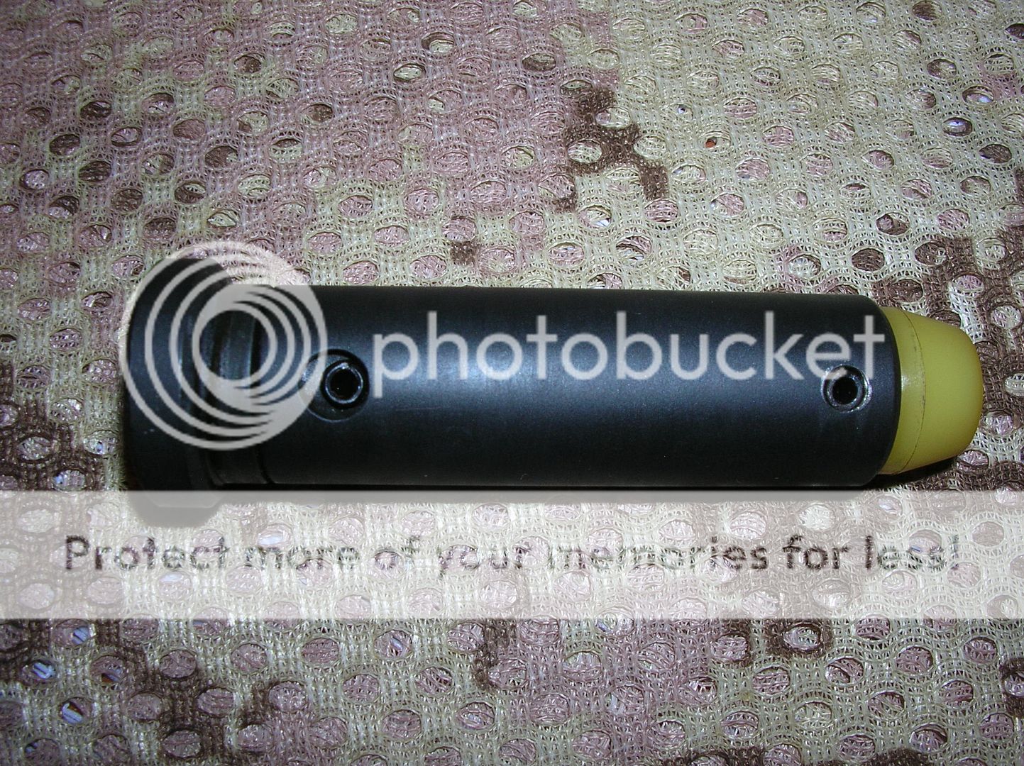

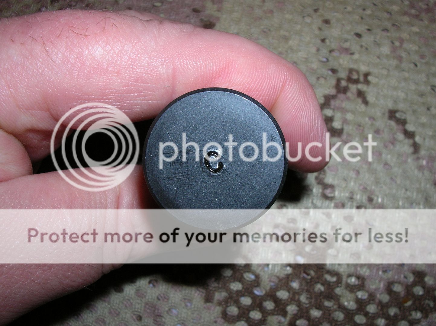

I made a spacer that goes in the buffer tube so the bolt does not get a running start at the bolt hold open. Limits the bolt travel.
