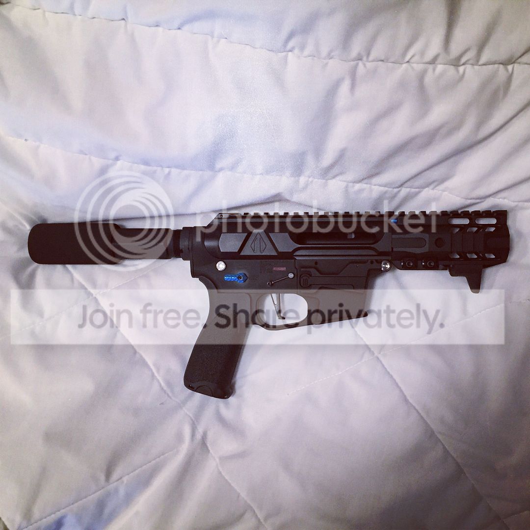

And here is a picture of the 9mm AR I almost bought off a range officer, before I decided to build my own instead. Its using the colt mags and its still for sale in the show room
