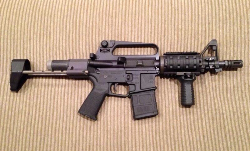

With that out of the way, I've had the hankering to build a nice little 9mm AR15 with the end result looking something like this:
I know the Rock River Arms lowers are available, but if possible I'd rather do a dedicated 9mm lower that accepts Glock mags such as the Double Diamond or Lone Wolf dedicated lowers.
So, what are the options? :D
