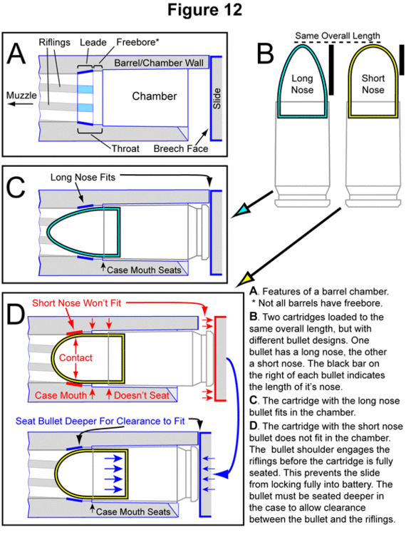

How did you determine the max OAL for your Range Officer barrel? What bullet brand and weight are you loading? Here's some useful information...
