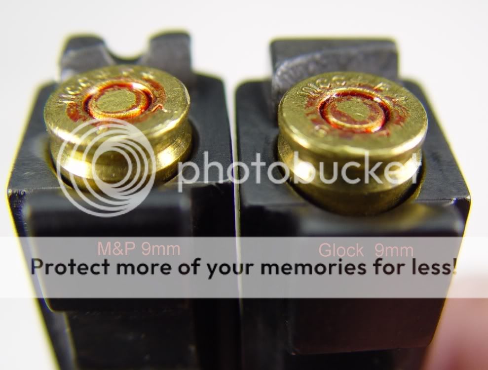

Evidently, your are using range brass... and let me welcome you to the bulged brass World! [insert fireworks and cheers here]
Common to 9mm and .40SW calibers, the bulge is caused by cases not fully supported by the chamber. I call those "glocked brass". Here's an illustration stolen from ar15-com:
Depending on brass and loads, most cases are successfully reloadable and the use of Lee FCD increases that rate. However, some stubborn cases have "memory" and the bulge will spring back: they are the ones that will not fit your case gauge.
Many .40 reloaders fix the issue by systematically processing their brass trough a "bulge buster" die. If you have cash to spare, you may care to invest on a Case-pro-100.
Word of caution: if the rounds failing the case gauge show pressure signs like a ring near the web or head, pull them and discard. Yours hands and face thanks you in advance.
