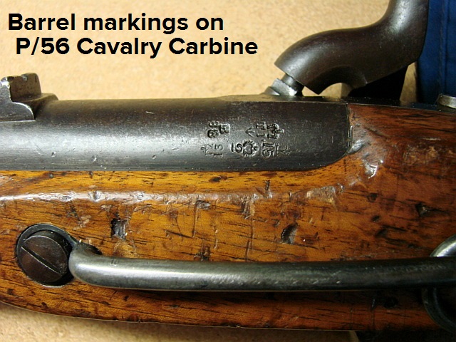

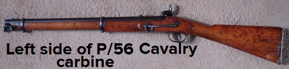

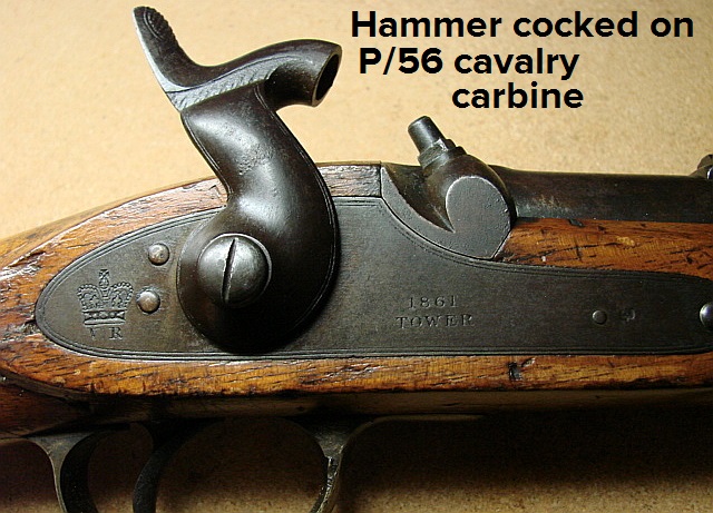

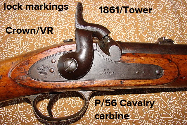

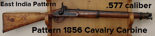

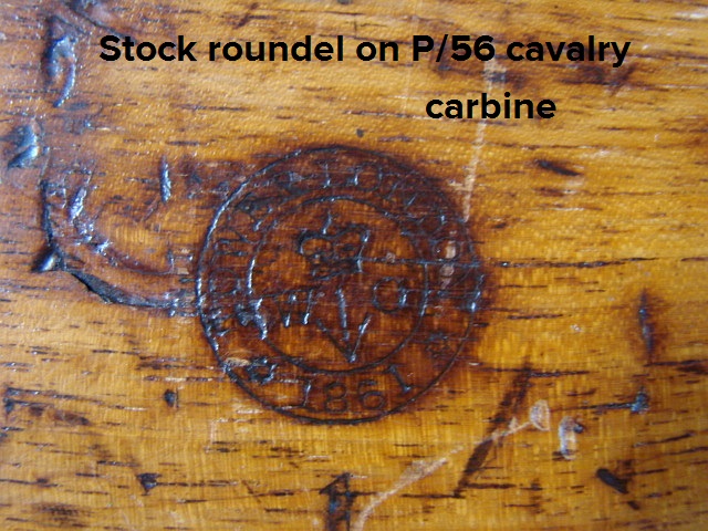

A .577 cal. carbine not often seen ---lock dated Tower 1861.
drm3m
13   0   0
Montreal Quebec

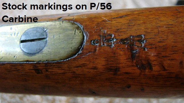

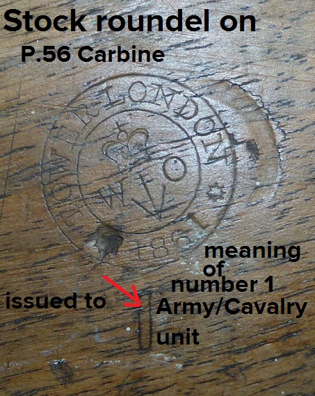

1 means first quality interchangeable parts, lower number parts are not interchangeable.
Some comments from an expert back when I made the trade.
Your carbine is a standard P56 East India Pattern carbine, but was issued to a British regular unit, hence the numeral 1 and the Tower roundel. The 1 signifies issue to a regular Army/cavalry unit.
Some VR marked Enfields were imported, but only those made by London Armoury Company as they used the same locks on their commercial arms as they used for the British government contract pieces.
That is a nice carbine. It appears to be a straight British issue piece as it has the WO stamp and a 1 class designation. The marks should all be covered in The British Soldier's Firearm. Congratulations on acquiring a crisp specimen.

"The large figure beneath the roundel denoted the class of arm. Those in the first class were for issue to regular troops, those in the second for the volunteers and the Militia, whilst the third class were reserved for recruit drilling in regimental depots. Any first class arm which had been repaired to any great extent was regarded as second class and the stock marked with a figure '2' in place of the '1'." - Subsequent repairs resulted in additional figure 2's. It is not uncommon to find a weapon with a 1, sometimes struck through, and also a large 2, but occasionally a piece will have a 1, and two 2's.
