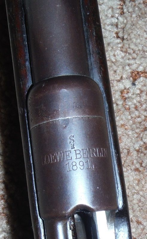

Hi all,
Just thought I would share with you all my Commission 88/05 rifle. These rifles are one of the many niche firearms I quite enjoy collecting. This particular example was made in 1891 by Loewe in Berlin. Sometime around 1905 this rifle was converted to the 88/05 configuration (change in caliber to the Patrone 'S' round, sights modified, stripper clip feeding instead of Mannlicher Clip feeding), and from there would have served with the Germans on the Western Front in WWI (this rifle is surprisingly still has a fair bit of matching parts, and the barrel band still has the regimental marking of who it was issued to). After that it was sent to the Ottoman Empire (Turkey) to assist them in arming there military, and it would have served the Turks through the rest of WWI and the conflicts they fought in post-WWI.

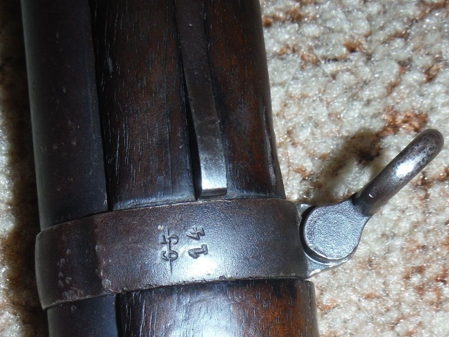

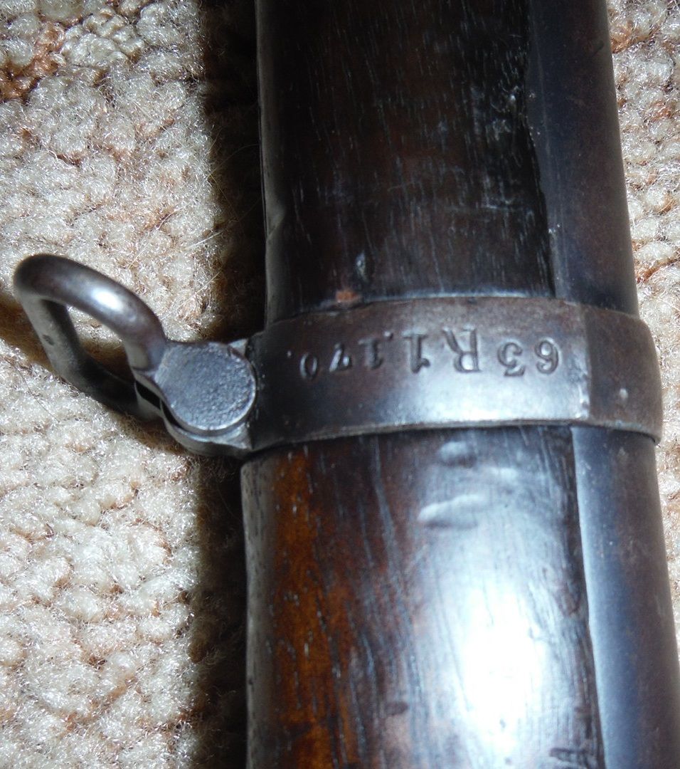

For those interested it was the middle band and the magazine which were matched to the rifle (would have been in German service, as the Turks really didn't care about keeping matching parts together). The barrel jacket also matches to the rifle.

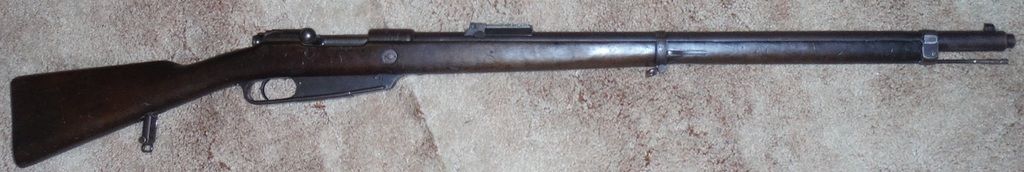

Again, love these. Here a few pics of mine for fun - 88s and 88/05. The 88s is all matching and has the only 1903 S update, while the 88/05 has seen it all and has seen too much

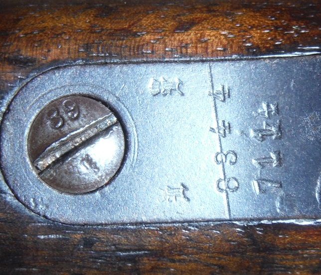

Thanks for posting. I bought one of the bunch that Corwin had and am reading everything I can find on them. I've looked through a bunch of manuals and have not found one listing for 8x57J yet. They all have a warning about it , but no data for the J. I see in Peteroliver1234's post the cutout for the stripper clip on top (and the cut at the front for the bullets) , but what is the cutout on the left side for?
The cut-out on the left hand side was for to make it easier to load stripper clips, his is much more excessive than most I have seen, mine only has a slight cut there. For loading the J cartridge first thing you need to do is slug your bore, it generally will have a .3215 dia grooves. Then you can use bullets that size or under with the minimum-mid range load data from most American reloading books, as they purposely keep it on the lower end of things. You do have to remember these did shoot Patrone 'S' which was a 150grn bullet at 2850ft/sec though that is generally considered unsafe to shoot through them now, it still for the most part handled it. Just stay at the low range, and you should be fine provided you are using the right bullets.

When you see a deep thumb cut on the left like that, which chops through the Gew. 88 markings, it's a sign of a Turkish rework.
