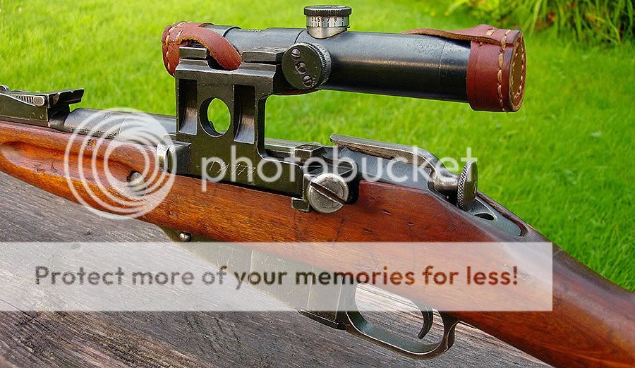

  1. How do you mechanically zero the PU mount?
  2. What Soft Point ammo is available in Canada and what are the grain limit's for this caliber?
  3. Would free floating the barrel & bedding an after market ATI stock increase the repeatability of this rifle?
Mechanical zero is pretty strait forward. If you're planning on removing the scope assy at any point, remember to only punch the bottom vertical adjustment screw, and don't do it until you're absolutely sure! That way you can loosen up the top screw and make it easier to lift the scope out.
