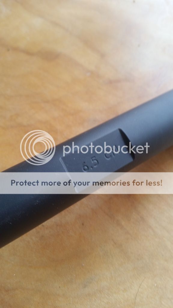

J996 the barrel was made by Bartlein for Eurooptic. They even machined a flat spot into it which makes me think I didn't have to buy a special barrel vice.

Ok that is an AINA spec barrel and I believe they are chambered for them by Dave Tooley. That will bolt up and be in spec.
The flats on the barrel are for rifles with quick-loc like the AT and new AX if the barrel needs to be broken loose in the field.
Your older AE will require you to use a bench mounted barrel vise (like in the video you posted).

This is the flat part of the barrel that made me wonder if I had to spend hundreds of dollars on a barrel vise.
