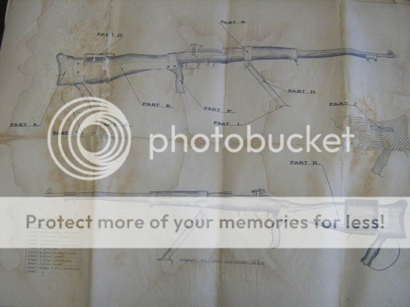

10 Ross Rifles had their stocks modified to imitate the Boys Anti-Tank Rifle for training purposes.

I only scanned the docs quickly because they weren't what I was actually there to look for. I'd love to make copies but their reproduction costs are insane and there are at least 200-300 pages worth of information there. Next time I go I'll take some pictures of any documents that you guys might find interesting. The pseudo-Boys rifle looks really interesting, and there's a huge blueprint I can photograph.

That grip on the pseudo boyes rifle looks like something from the planet of the apes movies. I can understand why they went to the .22 inserts for the boys.

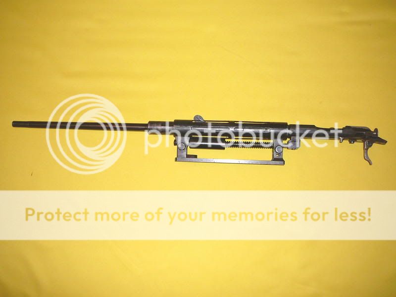

Not inserts, but a piggybacked receiver/barrel. Cooeys I think.

Anti Tank rifle sub calibre unit...
The Finns did the same thing with the Lahti 2cm M26 Anti tank rifle as well.
Picture attached. Fired by a Bowden cable to the trigger of the AT rifle. The receiver and barrel is a MN 91/ rifle converted to single shot in a recoiling mount. I have a spare one for sale/trade, so if anyone is interested, drop me a line.
All I have ever seen were the rifled cooey sub cal rounds. I have 2 or three, but only one with the center adapter. I have to lathe out a couple spares when I get a chance.

Be careful with the .22 sub cal units for the Boys. They had a tendency to ring the barrel which was the reason their use was discontinued. There is also one type with the chamber off centre to allow the use of a .22 round without the "normally lost" plug/firing pin.....
I can't use them anyway....my rifles changed over to 50 cal. I have never seen one of the offset ones.
I stand corrected :D I had only seen pictures and documentation regarding the piggybacked .22 set up. Unfortunately they were all on microfilm and of bad quality so I couldn't get any copies to post on here :( If I find any easily reproduced copies I'll make sure to post some.
