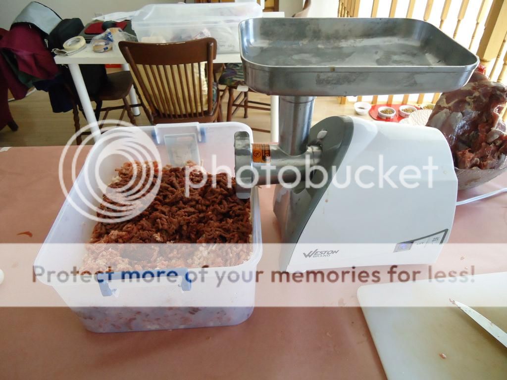

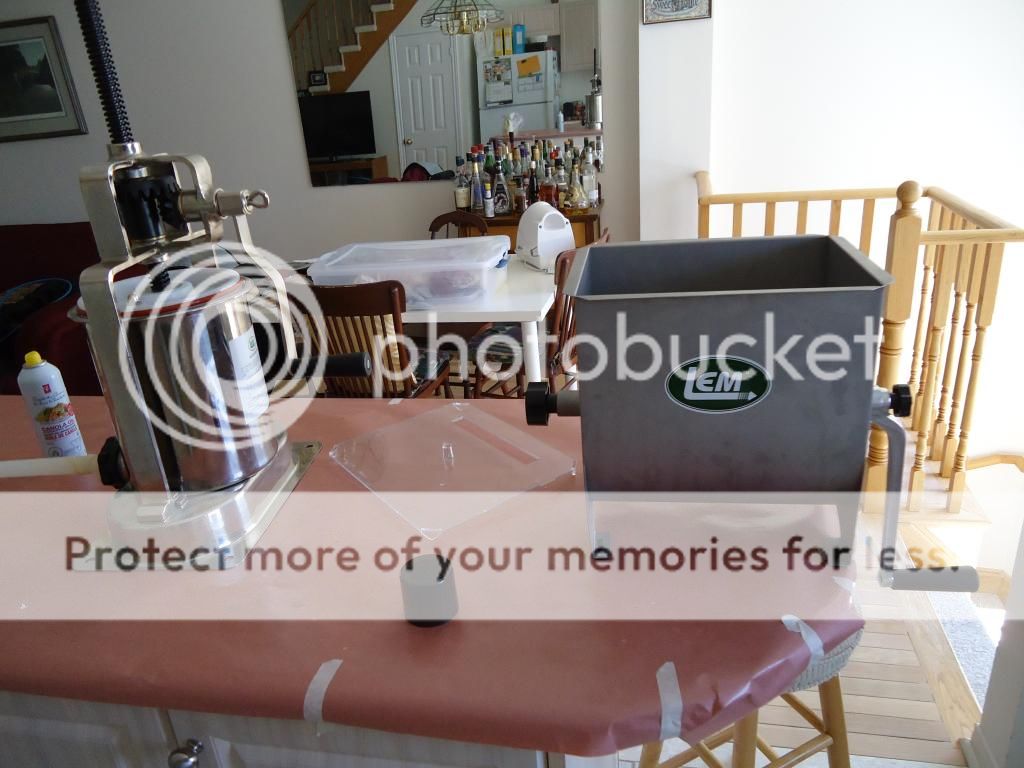

prepping worktable, butchers paper and setting up grinder
grinding the goose through the medium plate
grinding the pork through the coarse plate, i like to have large chunks of fat in my sausage.

mixing each batch with the spices and stuffing

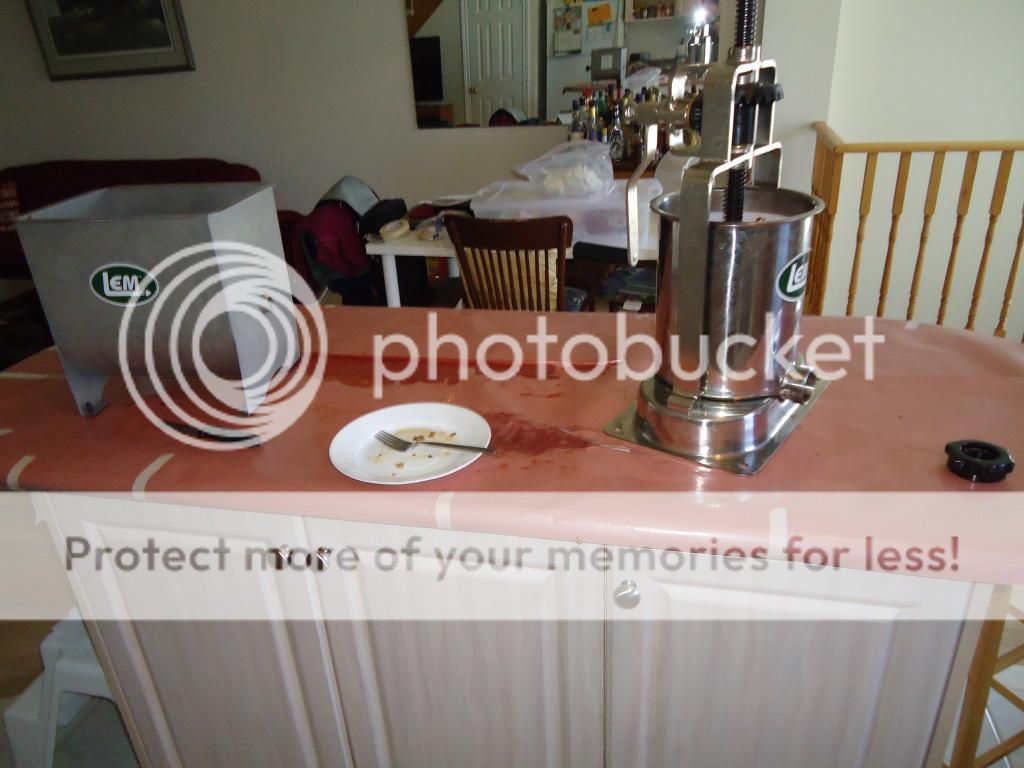

taste test, YUMMMMMM
end result , about 10kg worth of sausages
clean up time and vacuum freeze some for the next few weeks.

I guess it's too late now, but never put your aluminum grinder parts in a dishwasher, the corrosive cleaners in the soap will remove the adonizing and leave the aluminium dull and stained looking. Nice sausage, recipes would be good though.

One difference that may make your sausage more enjoyable. Course grind the goose, and fine grind the pork. The chunks of fat in the pork through the course grind end up taking on a disagreeable texture as you chew through them. A course grind on the waterfowl leave your sausage with a nice consistency, fine grinding both however makes your sausage like the inside of a hotdog.
