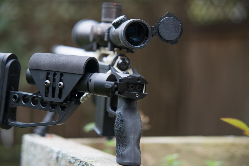

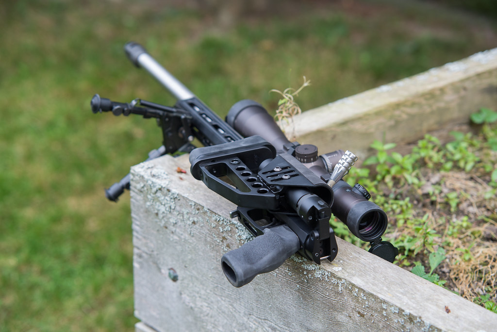

If I can offer one tid bit of advice before I get started, get the folder. Just don't ask, listen and get the folder. Fitting your rifle in a bag or case with the buttstock folded will save you space and money due to smaller cases/bags having smaller price tags.

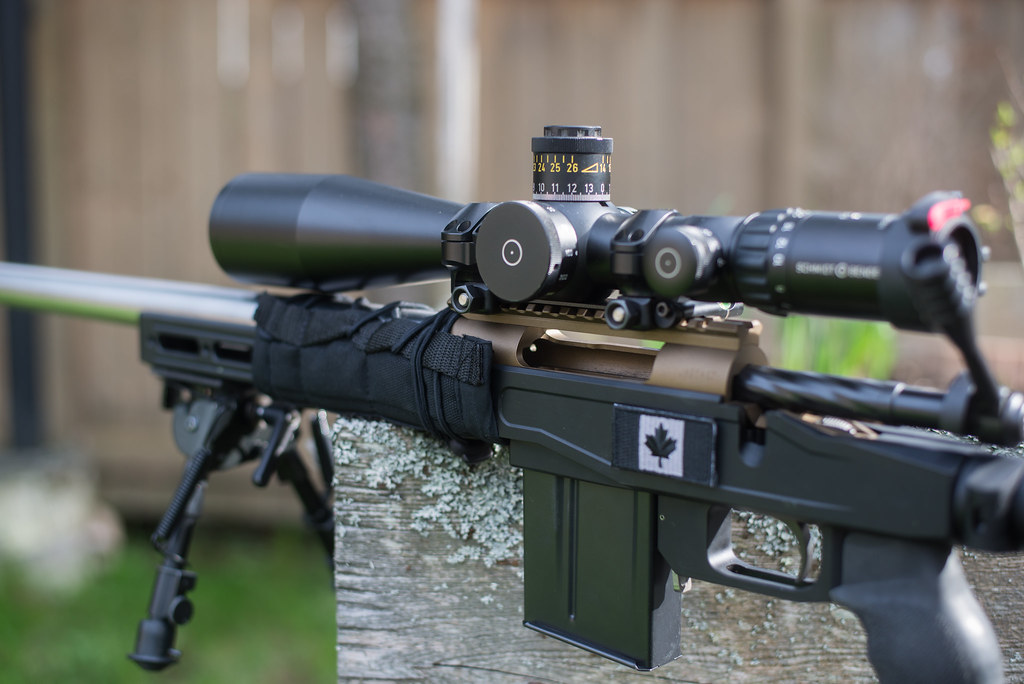

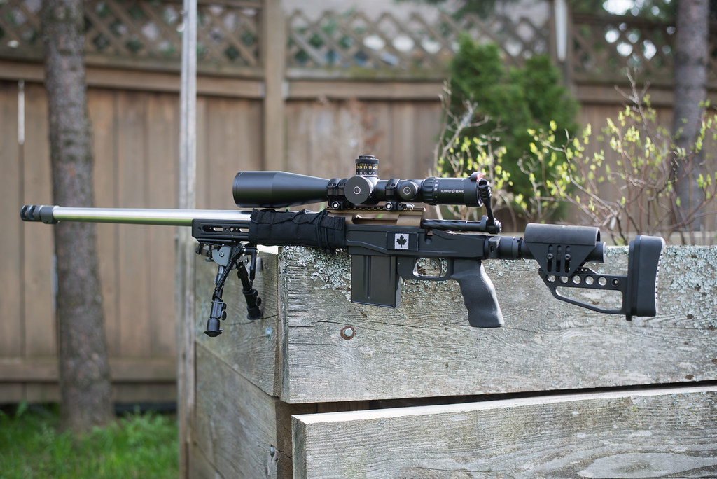

If anyone has specific questions on the rifles/parts, I'll do my best to answer them in the comments. In short, the Savage is chambered in .260 Remington (By Casey Brouwer from Tactical Ordnance) and wearing an XLR Element Chassis and the Tikka is chambered in .300WSM (By Steve Emblin from EM Precision Rifles) and sporting a McMillan A3-5 Fiberglass Stock.

Now if the word “gunsmith” turns you off, buy the chassis. Period. The way manufacturers build these chassis now offer the shooter a “do it at home” installation. Drop your barreled action into the chassis. Torque everything down to the specified weight. Start the car and go shoot. That's pretty much it. If you don't want to send your rifle away, get the chassis.

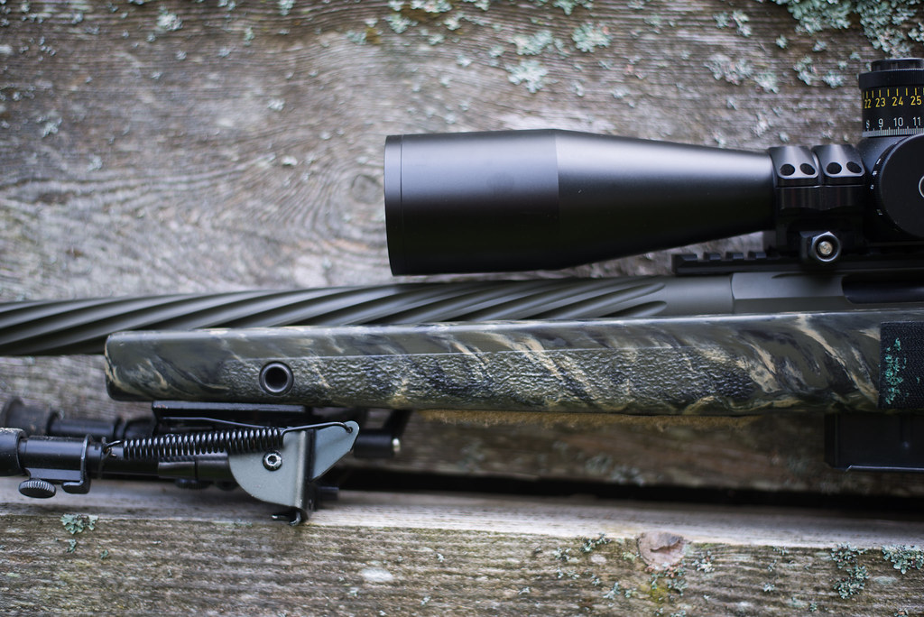

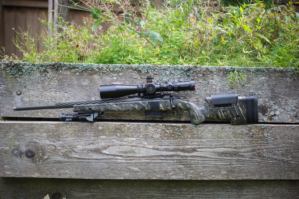

Now if you don't mind the waiting game, consider a fiberglass stock. These have to be ordered because of a few things. The main reasons are barrel contour and Bottom Metal. Almost all chassis will accept a straight taper in the barrel contour department while fiberglass stocks need to be ordered specifically for the barrel contour.

Now, from what the smiths told me, fiberglass stocks “should” be bedded, while chassis’s don't. If you want to go the extra mile and glass bed a chassis, then, by all means, go for it. Again, this can be done at home but is always nicer when professionally done.
