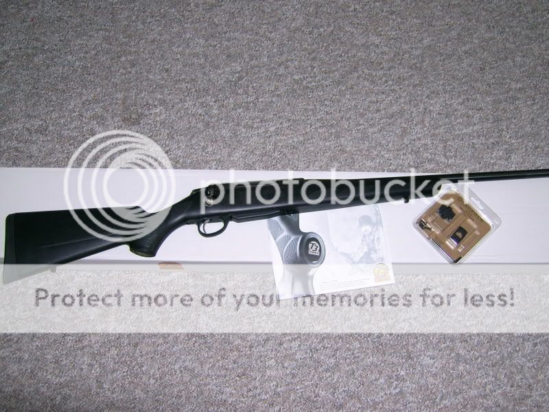

Although I have no brass or a cleaning brush. No stock. And I wasn't really about to buy a box of factory loaded fodder full of premium bullets just to try, so she will sit in waiting for awhile I guess. Although apparently I can make brass by "fireforming .308 Winchester"
Honest, I was told that. :p

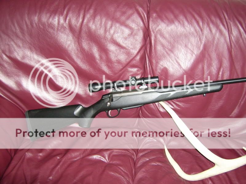

Well here's how it will sit for awhile. I have an old steel tube Weaver K3 that I mounted up top. I'll replace it with somthing better later. But this should hold up for now once I get some ammo put together. I'm excited to try this cartridge out.
