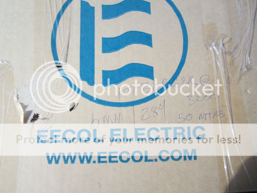

My 6mm-284 I found does not like 107 gn Berger VLDs and also would not hit the backboard.............So I tried it on a box at 50 mtrs and low and behold.........well it's pretty obvious what's going on. When I bought this rifle it was a 243 and I assumed, seeing as it was on a Remington action it was a 1-9, however it obviously is not and is likely a 1-10 barrel and even possibly a 1-12........Guess I'll have to try some lighter shorter bullets in it or change out the barrel for another I have in 243 and chamber it out to 6-284.
