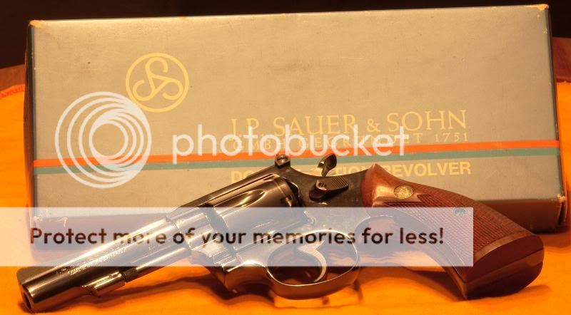

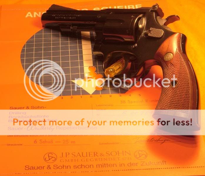

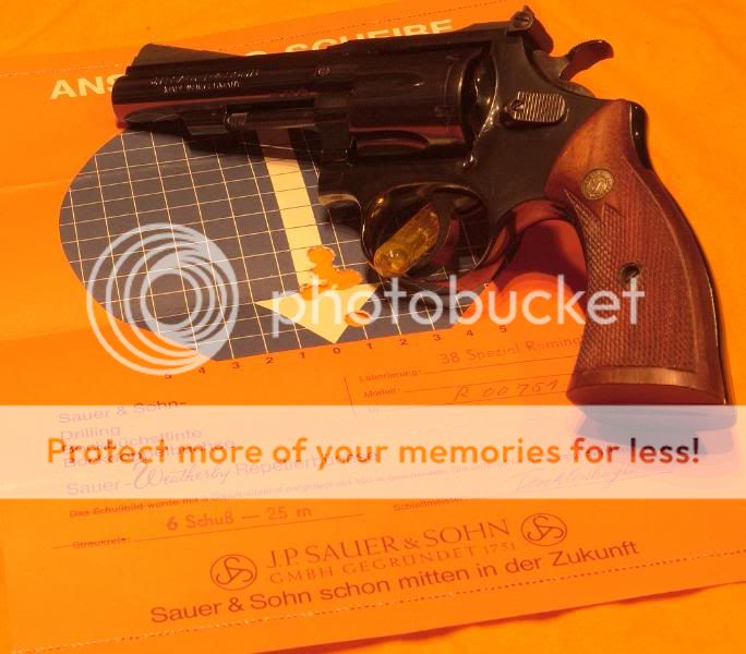

Here are pics of the piece...
"...ejector rod..." Yep. That's not unusual for this design. S&W revolvers it's a copy of do it too. Use a popsicle stick or similar high end tool to hold the ejector rod still and turn the cylinder to get the rod in far enough to open the action. Then tighten the rod finger tight.
Tried tightening the ejector rod. It wasn't loose. I t is as thought the release button is catching on something as you slide it forward. With the side plate off it works flawlessly. Put it back on and it at first works and then myteriously won't release the cylinder.
