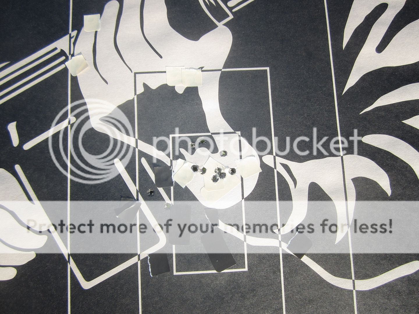

This is my 10 SNAP shots aimed at one target. I aimed at the center top of the white. It looks like I should aim a half inch lower, to make sure I get 10 bulls. The two out to the left are from the standing Rapid.

As you can see by my target picture, I used this technique in the PRACTICE session, to verify a zero issue. When I shoot left and right (as in the match) my group gets bigger and my zero gets lost in the noise.
But, as Bolivar points out, anytime you practice differently than you intend to shoot the match, there is a real risk of screwing up the match.
My scores in Mod Prone were never as good as I thought they should be, so I wanted to make sure I had the zero as perfect as I could so that the bigger group I get in the match has a chance of being centered for a max score.
