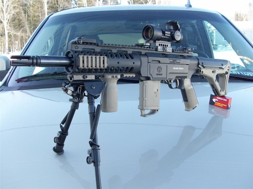

Yes you can use practically use any foreend that uses a free float hand guard. The OEM hand guard nut does not come off easily either. They use red loctite on it, and a AR wrench does not fit it. I took mine off with a set of channel lock pliers, my strap wrench just slid and didn't cut it. The problem with most of the aftermarket stuff is that the rails that come with them, will not sit high enough to line up with the factory scope rail on the Nordic chassis.
The only ones that do are from Dlask. They make a shorter 7" hand guard that comes with rails that are made to work with the OEM set up of the SR. Just take off the old pieces and slap on the new ones. I got this set up on my SR and is better than the factory hand guard. I don't notice any weight difference with it, but that may be because I use a heavier .920 barrel on it.
http://i270.photobucket.com/albums/jj90/magmasher/100_1222Medium.jpg
