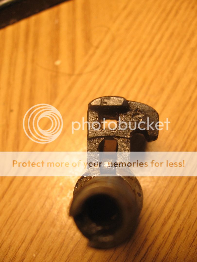

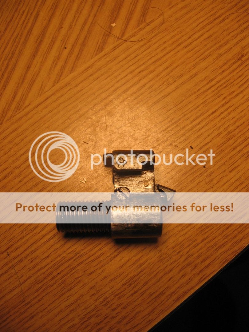

I have a bolt head and I am trying to identify, by the markings, if it is a number 0,1,2, or 3 head
I understand that they usually have the specific number stamped on the head.
This one doesn't seem to have a number.
Any help to identify this head number would be appreciated
The No 1 Mk III bolt heads were issued long and individually fitted. The trick is the find one longer than you need and carefully polish down the face on a flat, square surface.
