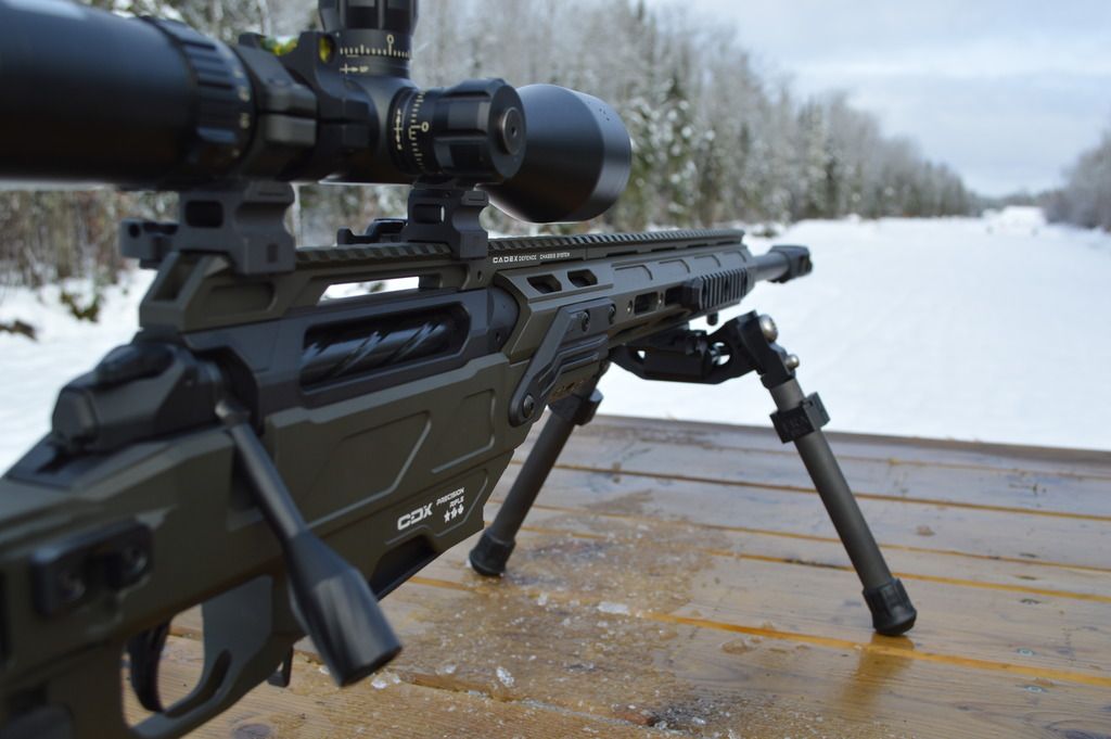

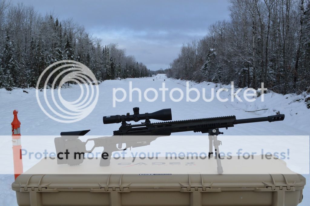

Well it took 9 months from the time of my order but the rifle has finally arrived! The heavy demand for 6.5 Creedmoor barrels south of the border is the main culprit for the delay. Now that it's here and I'm my hands I'm posting this quick review of my first impressions.

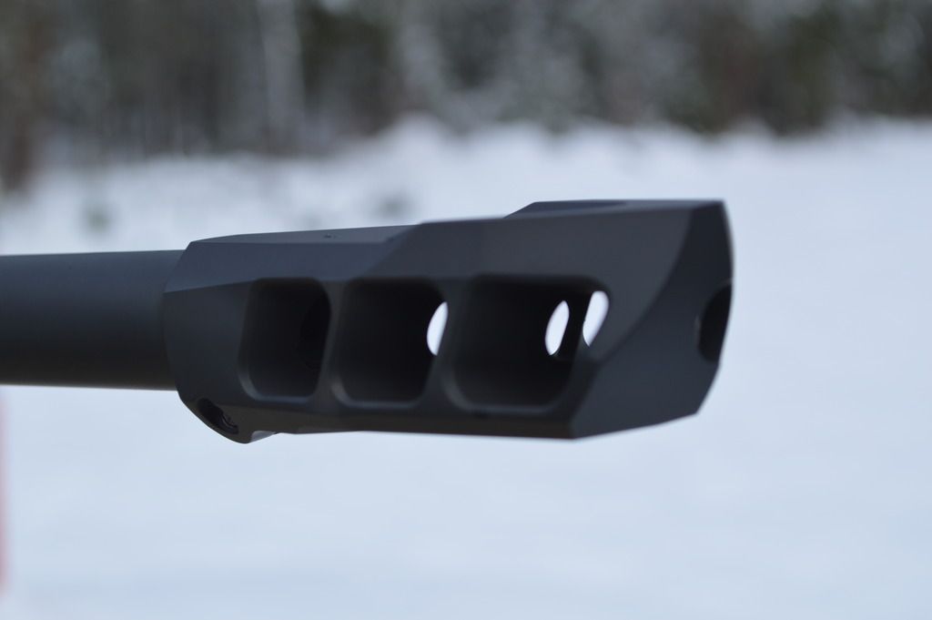

First the muzzle brake. What a pleasant surprise this little device has been! I've never fired a 6.5 Creedmoor before but there was literally no recoil. The very large butt pad no doubt helped, as did the weight of the rifle but the brake no doubt did it'a job. I had no problem whatsoever staying on target and there was zero muzzle flip and no movement of the rifle side to side.

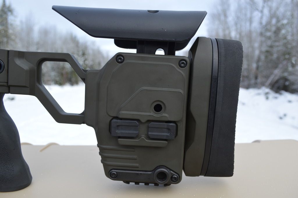

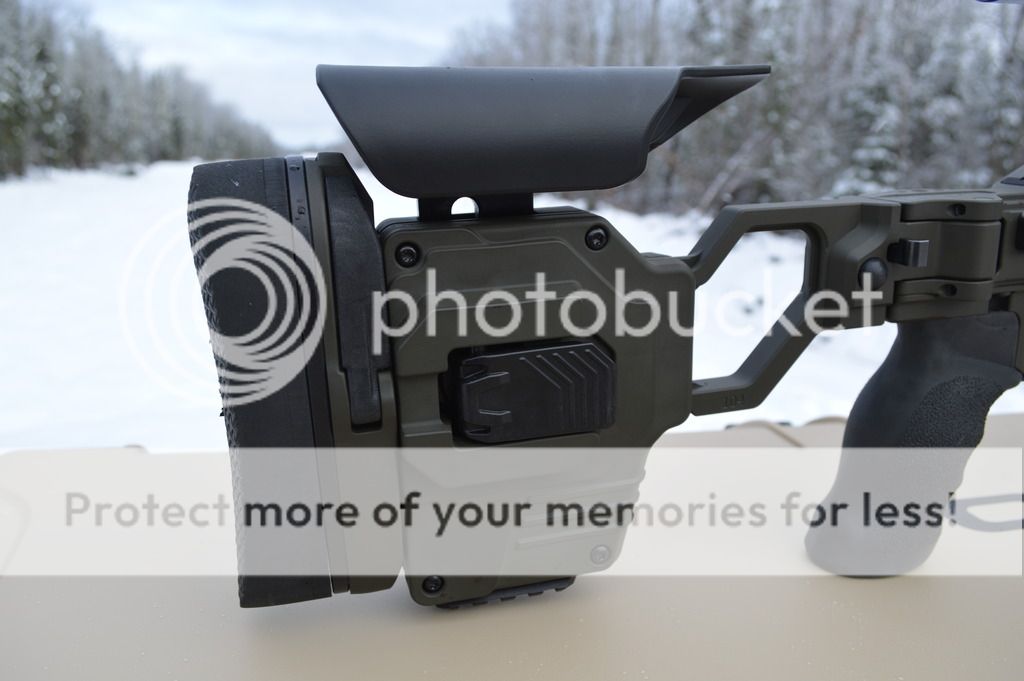

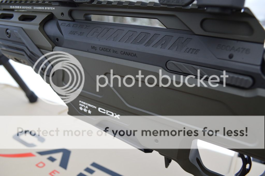

The butt stock. The butt stock is one of the main features that sold me on this rifle. My last long range rifle was a TrG-22, a fantastic rifle, but a rifle with poor adjustment and one that did not fit me well. The adjustments on the Cadex are fast, tooless and simple. Squeeze the two tabs to adjust comb height, flip the tab for length of pull, pull the lever to adjust butt stock height. The folding mechanism is bank vault smooth and the is literally no movement whatsoever in the butt stock.
The action. Impressive. It is probably smoother than my TRG-22 with very nice tolerances. The three lugs make for a very short bolt lift and it does not require much effort to lift the bolt. Very slick. My first complaint: the length of the bolt slows how quickly you can cycle the action. Second complaint: the bolt is so nicely made that if you try to cycle it quickly it feels like it binds on itself, but really, that's my fault. Third complaint: the safety can't be actioned with your shooting hand. However, if Cadex's goal was to make it idiot-proof, they succeeded, you can't miss the safety because it's right in your face.
Some final remarks:
The trigger. This rifle has a very nice two stage trigger. I fell in love with the TRG's trigger and so can't help but think of when when using the Cadex. The trigger is smooth in the first stage and perfect in the second when it breaks. If I could change anything it would be to add a little more weight to the take up stage and make the trigger blade a little wider and less concave.

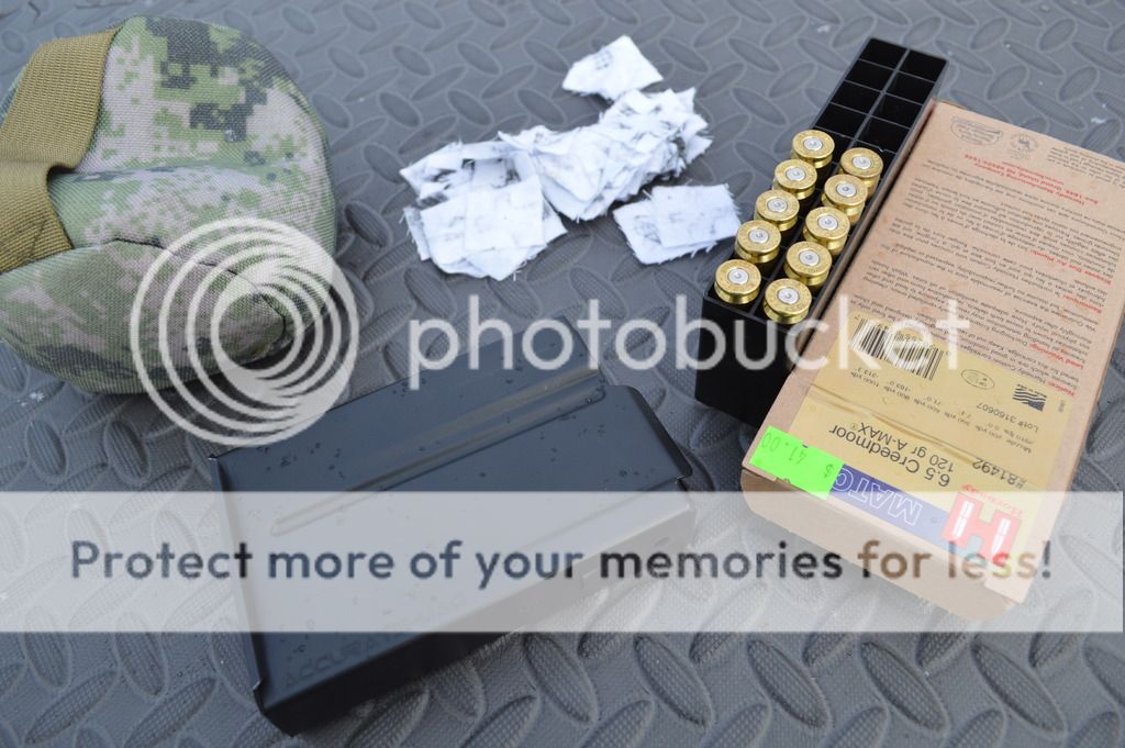

The mags. The Cadex came with a 10 round Accurate mag. I bought a second 5 round Accurate mag from the dealer. I've heard a few complaints about Accurate Mags. The mags are smooth and not nearly as hard to load as some claim. I did have two problems in the 20 rounds I fired. First: the spring did not push a round up hard enough causing the bolt to go over the mag without feeding a round. Second, when cycling the bolt slowly to keep your brass from flying into the snow (the Cadex really throws the brass) the mag can feed a round Crocker, causing a fail to feed.
Lastly, the height. Something many won't consider is the height of the rifle. Next range trip I will actually have to bring a booster seat. The scope sits so high that sitting on the bench I am not tall enough to look through my scope, and I'm 5'9" tall. The bright side is that the bore axis is quite low which no doubt helps with recoil management.

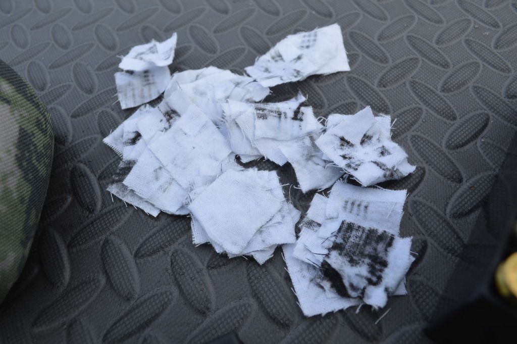

I went through a barrel break in that froze my fingertips. Hopefully it was worth my while but I'm not completely sold on these barrel break-in voodoo practices.
Shot 1, cleaned
Shot 1, cleaned
Shot 3, cleaned
Etc.

I was shooting 120gr AMAX factory ammo.
