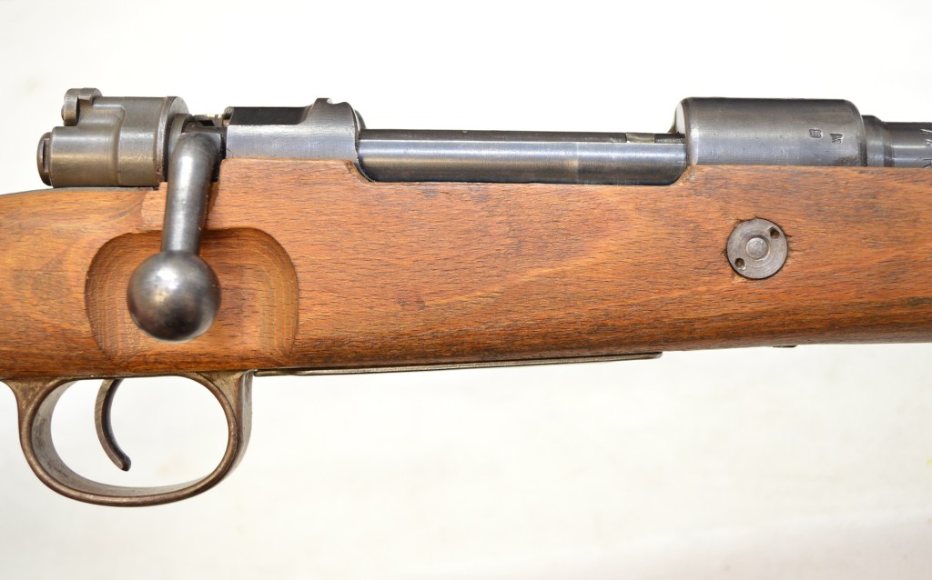

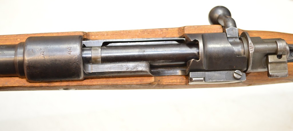

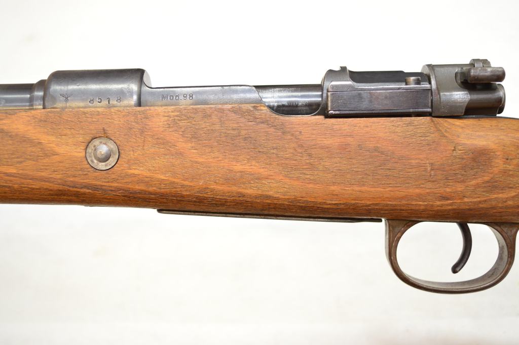

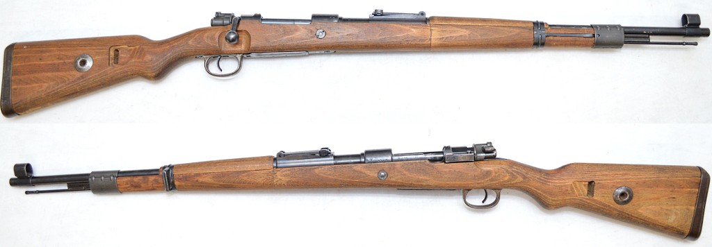

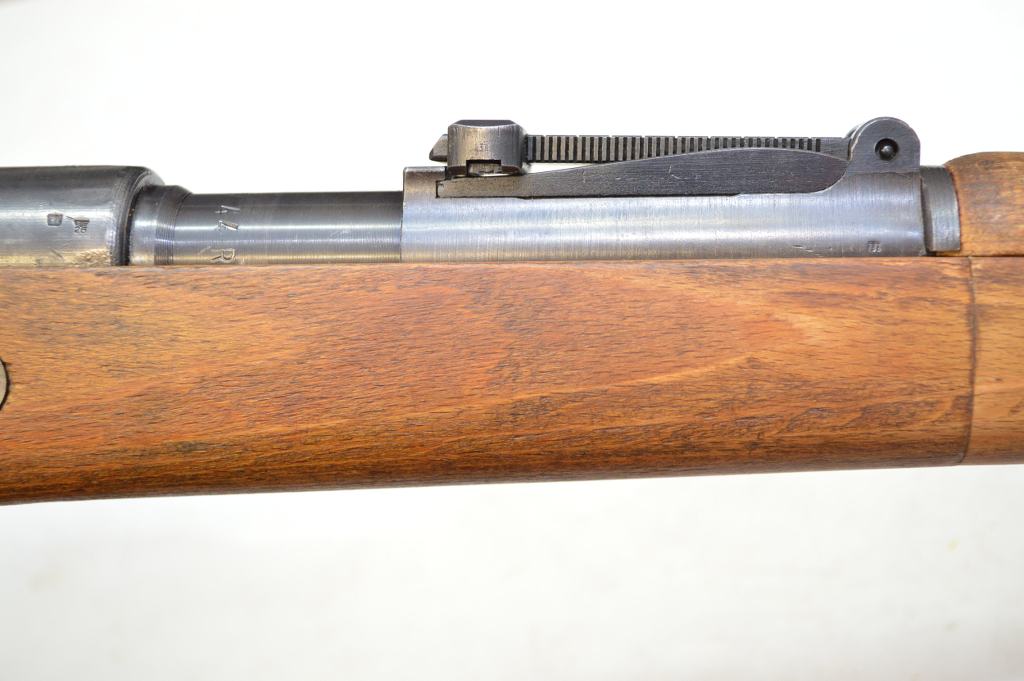

In 1944 and into early 1945 MO did several separate runs of K98k's where the receiver serials were all stamped by hand. The exact reason for this is unknown but generally they use up odd ball receivers or left over parts from regular production. Most of the early hand stamp rifles use up receivers shipped over from Mauser Berlin after they stopped K98k production. Later, MB started supplying MO with receivers and this is where the late ar44 series comes in. These start around the h block of byf44 production and go on into the early no letter block of byf45 production. Except for the serial always being placed on the receiver, they follow the number pattern of the letter block they were concurrently being produced with.

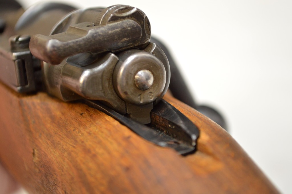

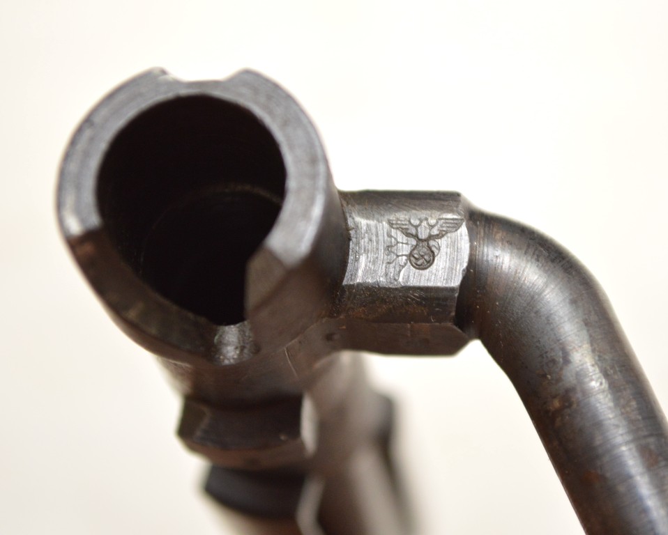

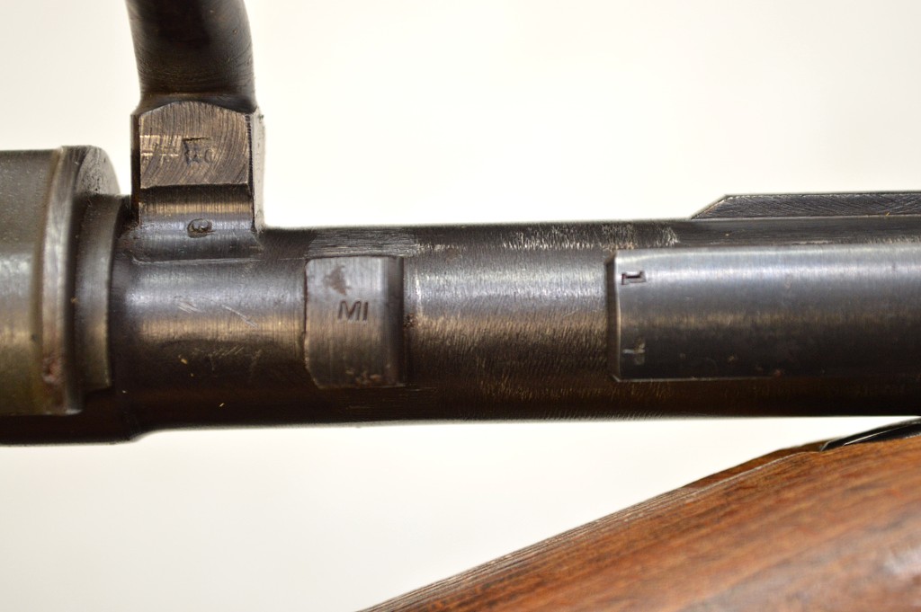

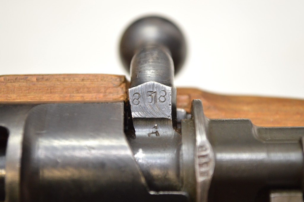

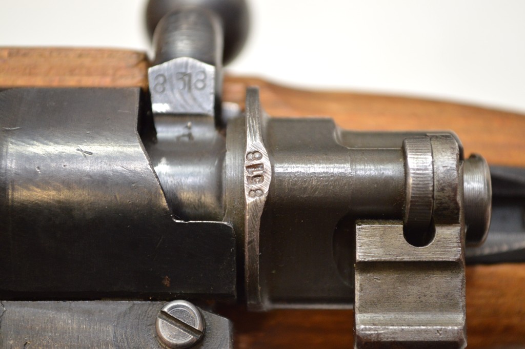

This particular example is a very late hand stamp and would have most likely been early 45 built. It has a mixture of blue and phosphate parts typical of late 44/early 45, a late barrel code and the late numbering pattern place it in this range as well. The receiver has multiple large dents on it and it appears they were really scraping the bottom of the barrel when they put this one together. An Astrawerke armorers spare extractor and interesting double struck firing proof on the FN supplied bolt are of interest as well.

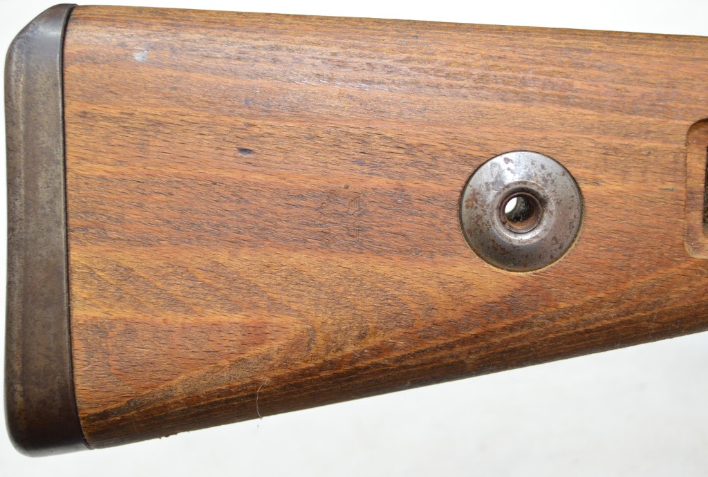

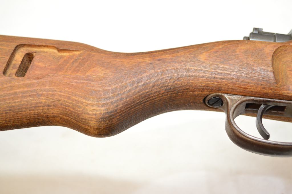

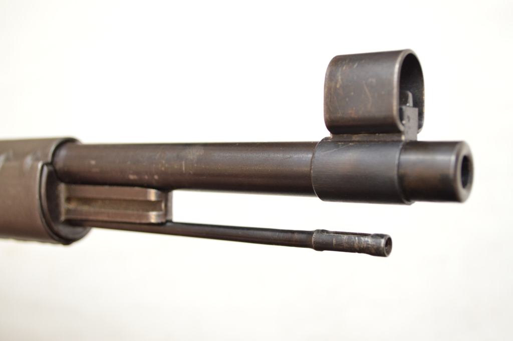

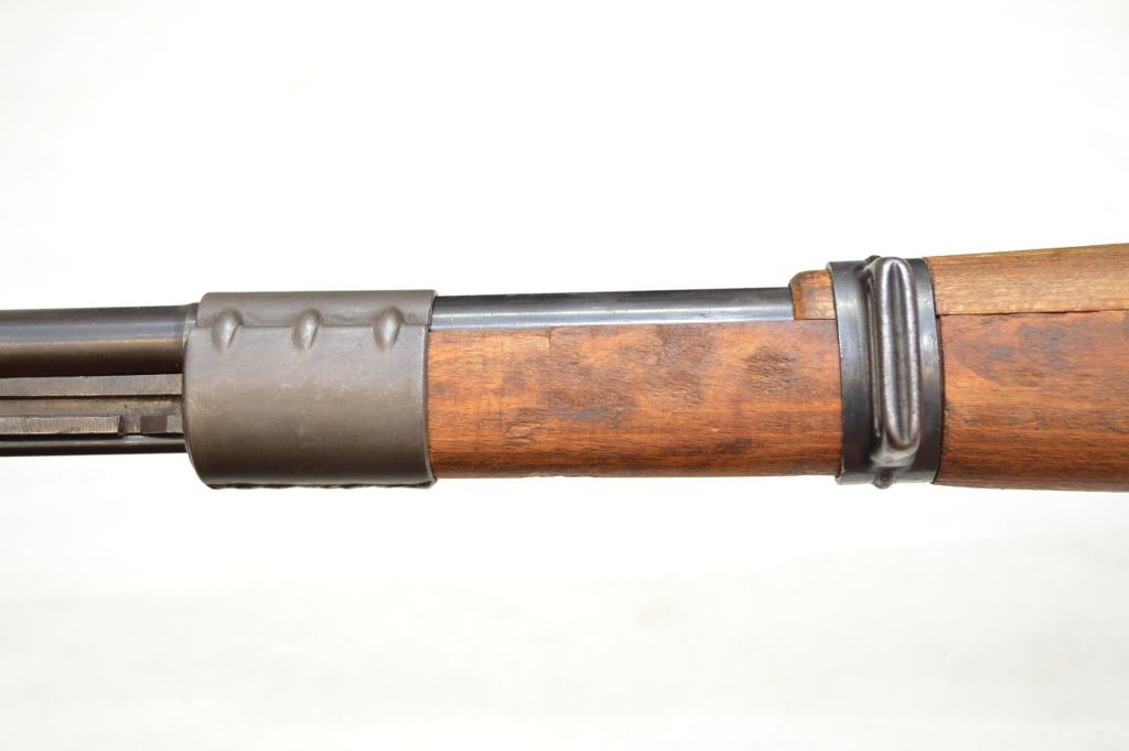

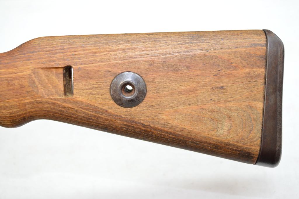

One other note on these hand stamp rifles is that they almost always use a standard stock, even into 45 when kriegsmodell stocks were the norm. Possibly, this was an attempt to use up left over or earlier rejected stocks. This stock has unfortunately been duffle cut right under the rear sight. It wouldn't be too bad if it was just glued back together but someone felt the need to sand around the joint and damage the stock further. It's a shame because the rest of the stock is really fantastic. A nice unnumbered white glue stock with nice chatter. Also somewhere along the way the original front bands were lost probably due to the duffle cut but since they were unnumbered I was able to replace them with appropriate MO made bands.
It is a nice rifle. How much do you think the duffle cut hurts the value JB? I know where there is a BYF 44(not rare, I know) that I would like to buy and it has a similar visible duffle cut. It is an all matching rifle though in the L block.
To me it depends on the condition of the stock and how the dc was fixed. Lots of guys won't even touch a visible d/c so to them the value takes a severe hit. If there's any sanding then I would say it takes a huge hit in value, if an untouched stock other than the visible cut then it would take less of a hit in my opinion but there's no getting around the fact that a bad cut probably takes off half the value or more. On this example I paid probably a third of what an untouched example would have brought. It went through multiple auctions before I approached the seller privately and made an offer. Nobody was interested in it despite the scarcity of it.

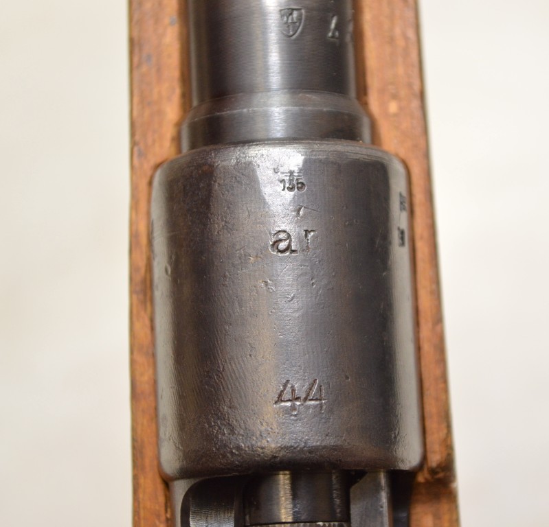

I don't know a lot about milsurps, but I thought byf was the code for Oberndorf, not ar ?
Yes, byf was the code for MO during 44 and early 45 but they also used receivers from other manufacturers. ce43, bcd43, ar43, bcd 4, and ar44 examples are known. It wasn't that unusual for manufacturers to use receivers from other makers and it was fairly common at Mauser Berlin, where the 43 dated examples most likely came from after MB shut down K98k production. The later bcd4 receivers were made by Astrawerke (Gustloff was just an assembler and never made their own receivers) and most likely sent to MO to help supplement production. Same with the MB manufactured ar44 receivers. MO was a giant and could produce a lot of rifles as long as they had the parts so often resources were diverted to them to help maximize their production capability.

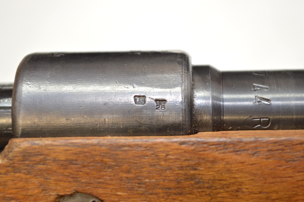

You will notice that the ar44 receiver has an e/26 acceptance on the right side from the manufacturer, Mauser Berlin. It also has an e/135 acceptance there from MO. The e/135 top final acceptance on the receiver is the biggest give away that this was finished at Mauser Oberndorf. The stock also has a WaA135 final acceptance for MO.
