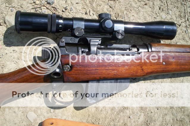

I bought a No5 with an S&K mount already in place . I don't know how many rounds it's been through proir to the 200 , or so , that I've let go but it's still holding tight.
I've got a Ruko 2.5X on it . A short scope that matched up nicely.
Just make sure your scope has decent eye relief , otherwise you'll be on the receiving end of a one punch fight.
Personally , I prefer those straight tube scopes on an LE .
Ruko scope

Excellent... sounds like that's a good match. Ruko 2.5 X... that's a little low powe isn't it? I would probably want a 3 to 9 myself, I have one on a .22 of mine and it shoots great... however, a short scope like that with Weaver rings seems to be what I need. Don't need a new eyesocket. :)
That S&K mount is very stiff and sturdy.
