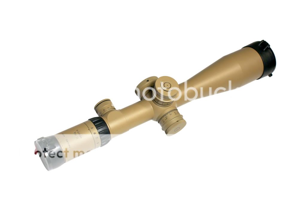

I broke down yesterday and bought a 34mm Sako 3-ring mount for my new TRG 42. When I got home I prepared to mount my S&B scope in the new setup. This is where the fun begins....
