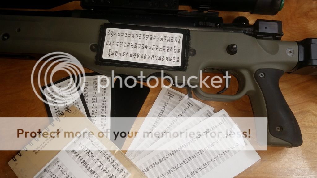

I was looking for a way to keep a handy dope card with my rifle that was easy to read. When predator hunting or competing in a match I often found myself using a ballistic app all the time.
I originally printed a dope card and tied it to my scope but it didn't always have the right dope in all conditions, plus it would often not be oriented the way I wanted it. I use density altitude and wanted a card for every 1000' that I could easily switch out.
I can not get tables to export from my Shooter app so I used Strelok Pro for this. I made up the tables I wanted and then emailed them to myself. From my email I copied the table to a spreadsheet program and tweaked it a little bit adding a spin drift foot note and highlighting every other line for contrast.
My old card had elevation corrections on one side and wind on the other side in 4mph increments up to 20mph. I didn't have enough room for that so I used an idea I got online and just put the 10mph hold. 10 is really easy to convert to other speeds. I printed these out on heavy paper and cut them out.
I went to Canadian Tire and bought a 15' roll of 2" velcro for $25. It was way more than I needed. I was a little leary about the stuff I got because the hook side looked almost smooth but it turns out it very sticky. I purchased laminating sheets from the dollar store but I used them a bit differently than it was meant to be used.
I cut velcro strips to the size I wanted and then stuck the cards on the hook pieces. I used only the sticky side of the laminating sheets and stuck that over the cards. That way I had the velcro glue and the laminate glue sticking together. Very sticky!
I did this for all the cards I wanted for the rifle plus I made some extras in smaller increments that I just laminated without velcro. I also left room in the margin to wrote notes with a sharpie.
Here's a crap cell phone picture:
You can stick these on a velcro loop patch on your rifle like I did or even a shooting bag with velcro patches. The Mil Dot Master has a spot to attach ballistic data and it would go there perfectly. I also used some of the velcro to reattach my Short Action Precision 2 shell holder and it worked better than the stuff that came with it.
So that's my idea. Other people have done it, it's not very original. I'm ways asking questions on this forum and thought this might help someone else who didn't want to have pull out their phone or write numbers on their arm all the time.

Those are a lot better than my idea kombayotch. I kind of wanted to see what other people were doing too.
The one thing I wanted to stay away from was a wrist coach as I use this rifle for hunting too and didn't want to have to grab anything but my rifle and maybe my rangefinder when I went.
