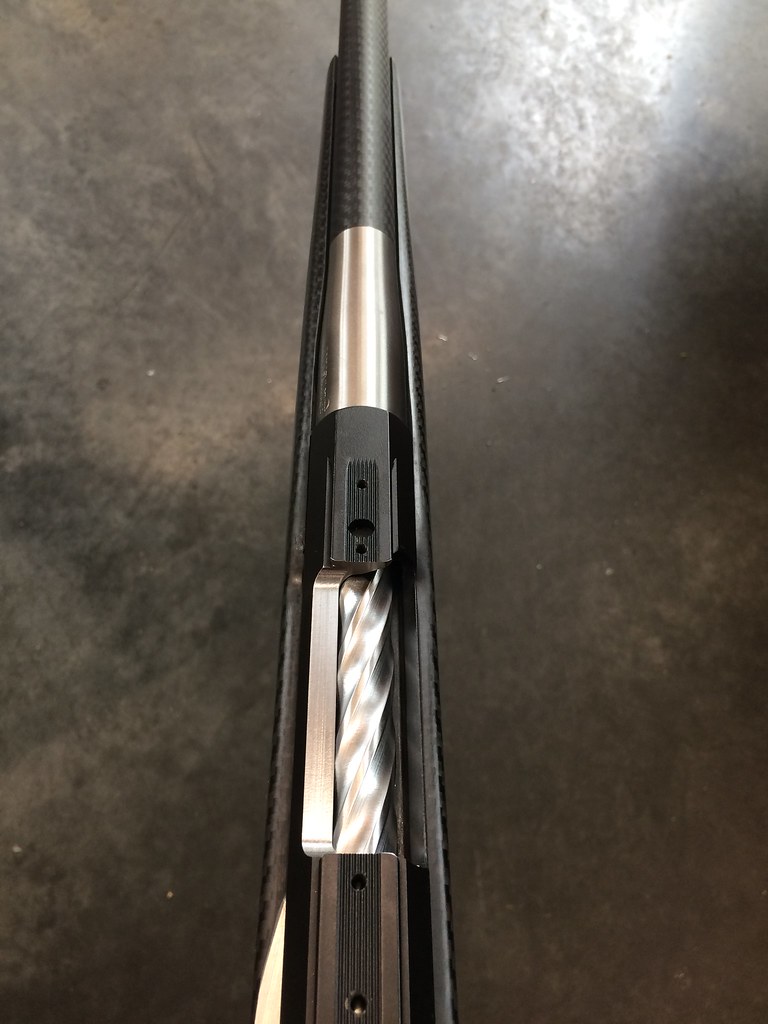

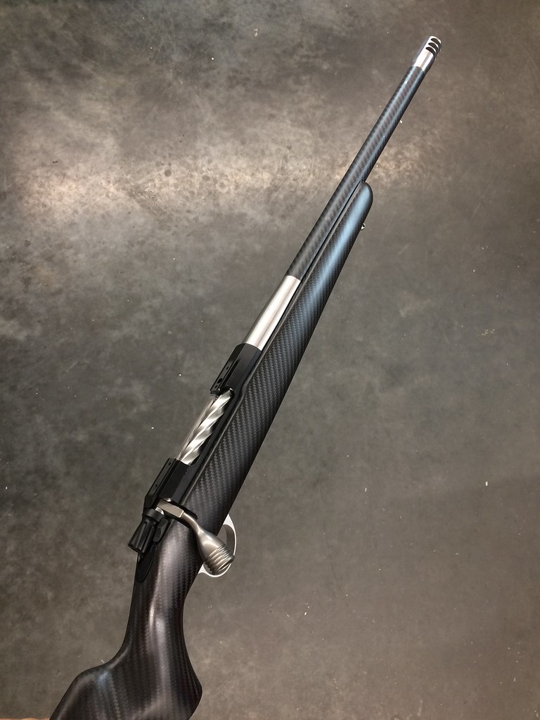

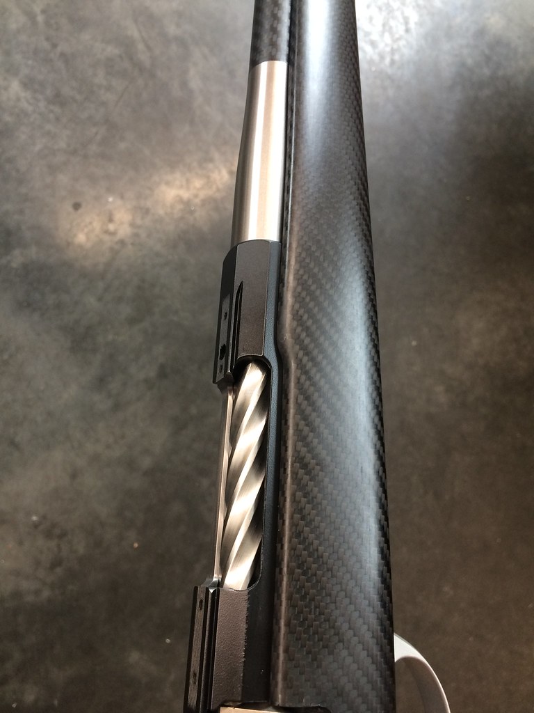

Here's a similar project I recently put together for a customer. Coming in at 6lbs even, the CF barrel cost him some weight compared to a good quality, light contoured barrel, but to each their own. It certainly made for a handy, light and solid rifle that balances well and comes up very nicely.
is the rigid action still on? thank you for the pictures,
Sorry medvedqc, are you asking if the action looses rigidity due to the sheep cut? My answer is always "yes of course it does!" This is an aggressive and intrusive modification that cannot be undone. It is done for trimming weight, for aesthetics and, some customers feel it makes dropping a single round into the chamber faster/easier in "stressful conditions".
The next thing I say is that: It brings the tikka action "down to the level" of all its friends: Sako, Remington, and every other open topped, mag fed, cylindrically based receiver out there. Those actions seem to do alright...
In the end, I cant say I've seen a difference on paper pre-post sheep cutting an action but there can be no dispute, opening the top of the receiver mathematically removes some level of rigidity.
