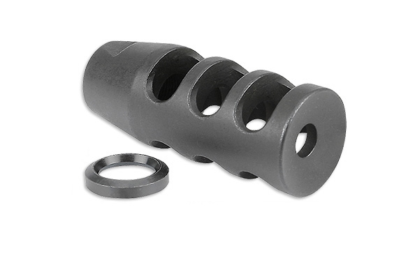

Budget rifle and budget muzzle brake.
Rem 783 223 HB 1/2x28 thread with midwest industries 3 ports muzzle brake.
I’d just go crush washer then, shims or jam nut it you want it timed (that particular brake looks like it would work best if timed). You might get lucky and time it with a crush washer, if one comes with it try that first.
Crush washer should be fine but it depends how tight it gets before it is timed. The wrench flats on that brake aren't very big.
