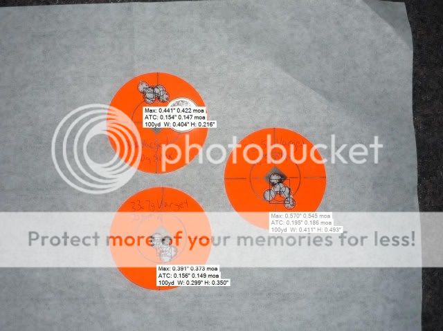

Here is the groups from load dev on my 6bbr savage i am selling

You are shooting very good groups.
